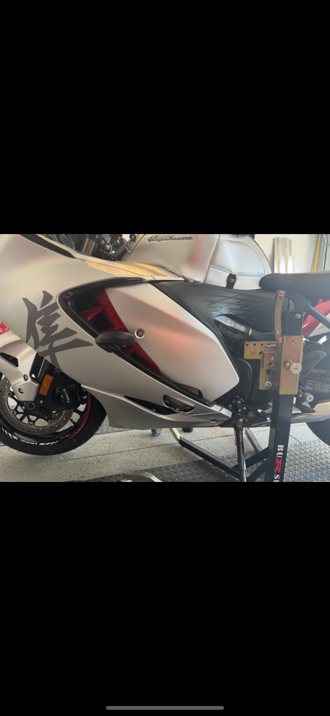

Sprayed plastid on the chrome boomerangs. Waaayy better looking!
mabupa
Mar 24, 2011
6,287
8,151
Certainly does change the look quite a bit......I don't know what Suzuki was thinking by putting chrome on a sport bike.....
