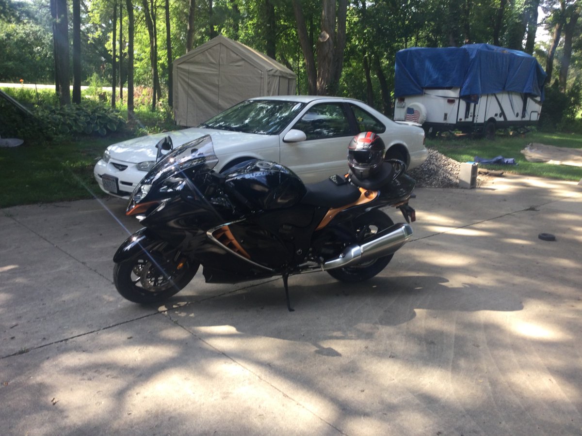

I have a 2013 Ford suv 1997 Ford T-Bird do not use the bird in any salt or snow

Chicken is from La was my dads with only 62000 miles on her.
A neighbor I had many years ago had an SC T-Bird;....it was black on black...he babied that thing but sadly lost it in his first divorce...he wife took it and he saw it a few months later being driven by her boyfriend (same one she had and the reason he divorced her).
He was NOT a happy camper...
