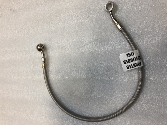

On the Hayabusa, it is a simple swap job. Remove old line, and replace it with the new lines from the kit. Many of us do Front/rear/clutch kits to make them all match. While there's likely not any real performance benefit with having a braided clutch line, my OCD wants that 'complete kit'.
Rear line is easiest so I'll do that first. Unbolt & replace, right?
Not quite. I didn't realize the two banjos bolts are different thread pitches. One is fine thread, other is coarse. Nuts.

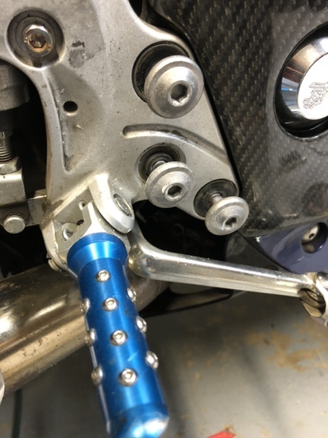

Once I figured that out, was a simple case of getting the line aligned. Aftermarket kits often don't match the stock lines exactly. But they do work and just remember to use two banjo washers on each side of the banjo fitting. Why they call them banjo fittings, I have no idea, maybe the guy that invented these hollow bolts played banjos. Plus you have to remove the right foot peg bracket to access the rear master cylinder. Line should be routed on the inside of the swingarm if you want to keep the original patch of the stock line.

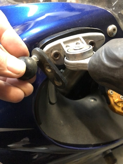

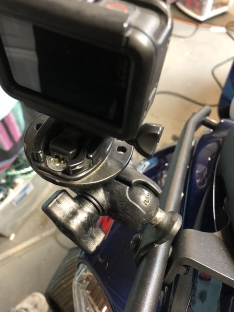

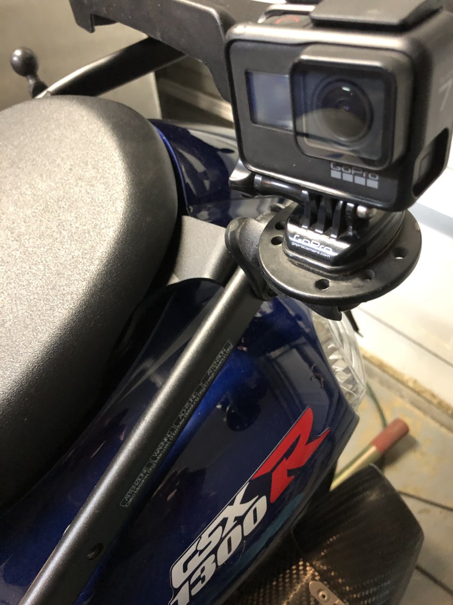

attached to the muffler hanger
1612674
on the the new Givi Rack
1612676

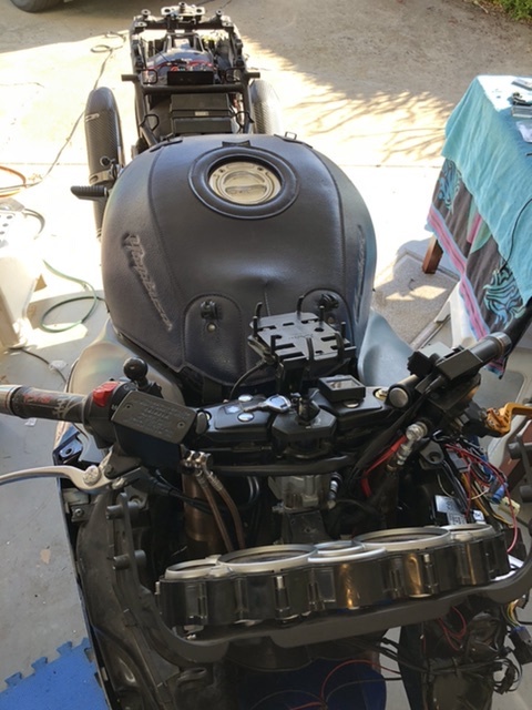

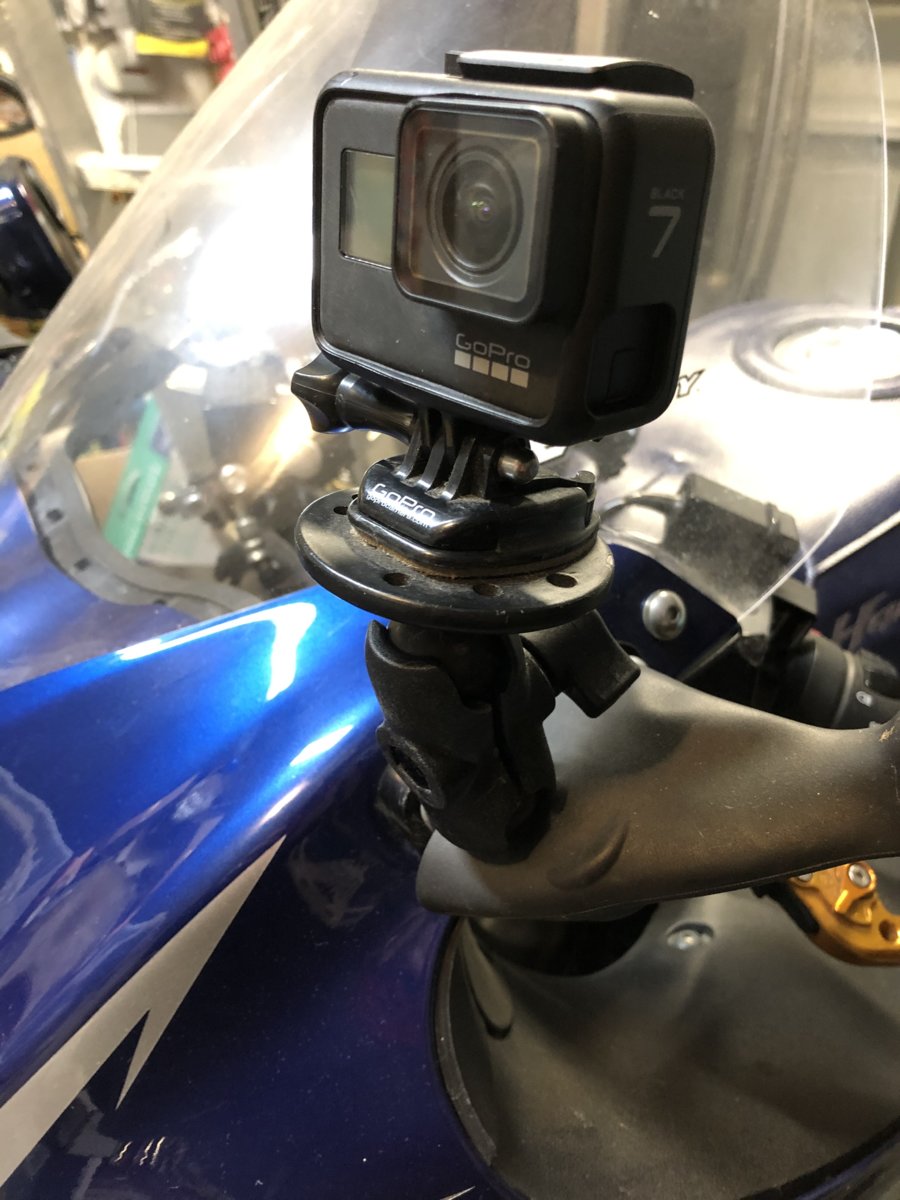

so now can attach the camera anywhere on the end of a flexible RAM arm I built
1612677

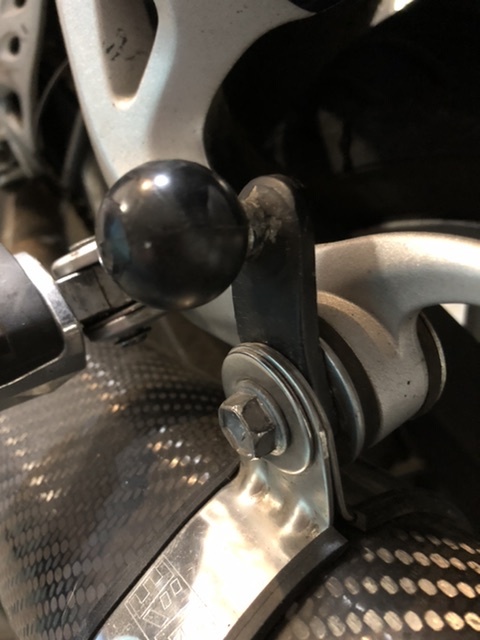

The flexible RAM arms I built with parts from ExpressMounts.com which is the retail site for RAM.
Lots & lots of experimentation on the previous 08 Busa & the '00 Busa. Some things worked. Some did not.

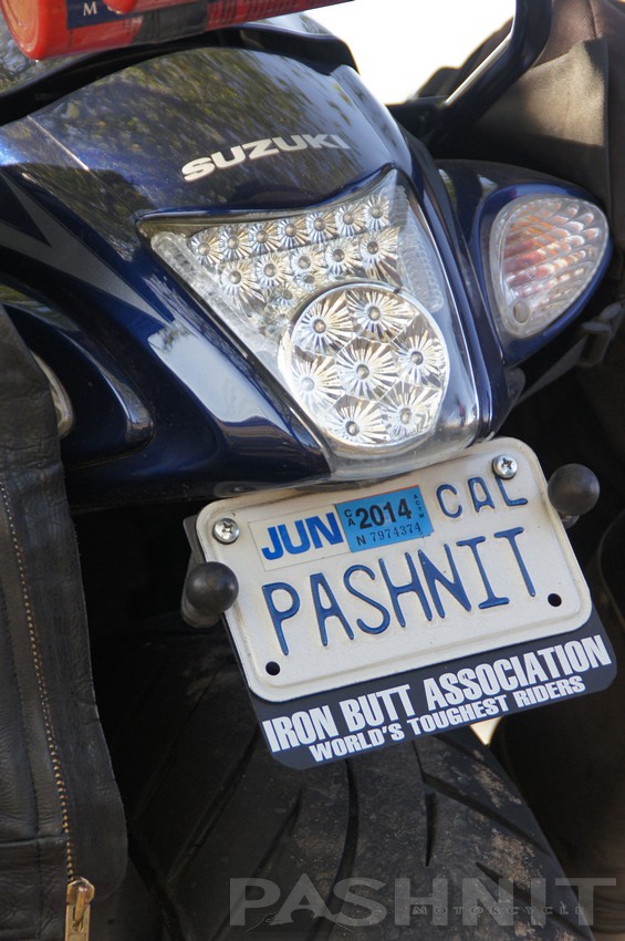

RAM balls even on the license plate bracket
On the end of the Throttlmeister bar end (yes, this actually worked)

After several years of playing one of the tour participants who was into RC cars built me a homemade GoPro Gimbal. The bike leans and the camera stays level.
No, this didn't work. Arm is too long. A second arm is needed.
But you can quickly see the possibilities are endless with a series of varying length arms and mounting points.
