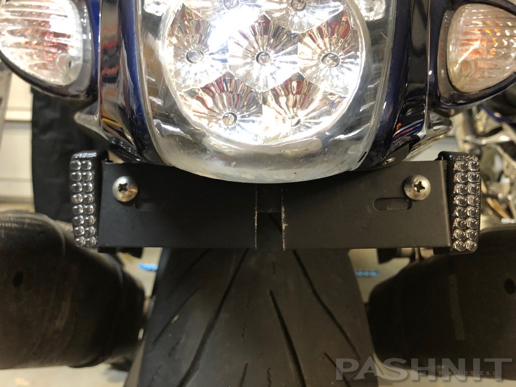

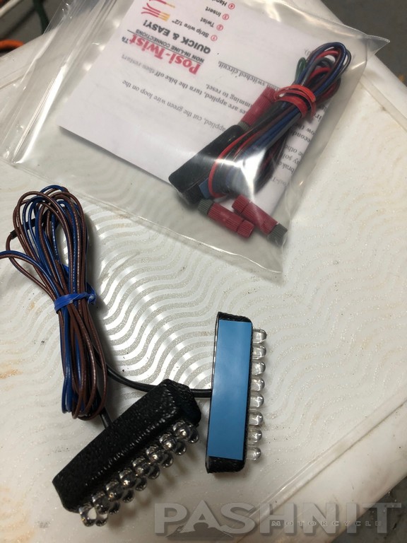

But you can always use more lights. Recently, a near miss on a right turn (someone behind me coming up on the bike) promptly me to stumble into a link for HyperLites.
I had these on the bike 20 years ago and I surprised to even find this company still around. I already have the Healtech BrakeLite Pro module on the Hayabusa which rapidly blinks the brake light, but wanted even more blinky brake lights.
Kit comes with the larger 16-light module and the 'brain' module which has several different flash patterns to choose from. I like it flashing as long as brakes are engaged.

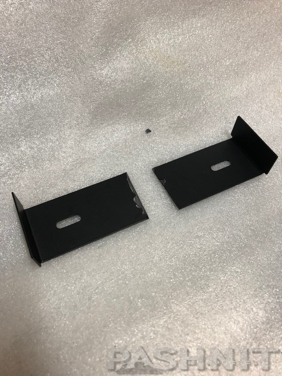

I bought the 16-light kit they had on the spot plus the bracket they offer. The bracket was way too big for the license plates so I got my tin snips out and cut 1/2" out of the middle of it.

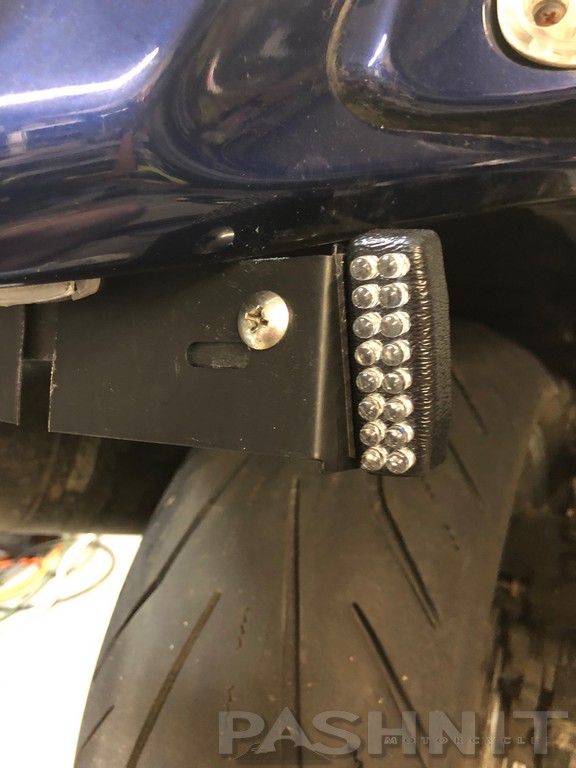

Lights attach on the sides. I could make my own brackets but it's just easier to buy off-the-shelf stuff sometimes. The bracket was an additional $11.

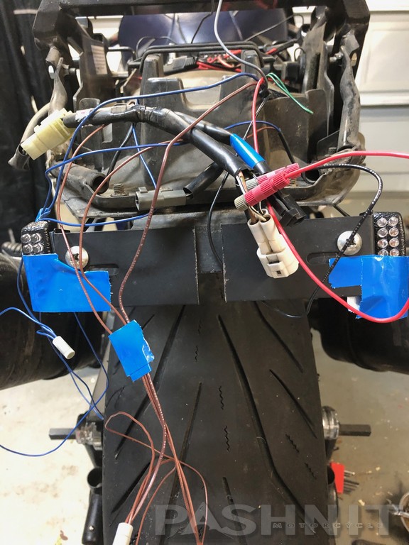

Now comes the hard part. I see blue and all the other colors look the same. Hide the women and children, the <very> colorblind guy is doing wiring again.
Small holes for the wires in the undertail

Mocking up the wiring. Process of elimination to get the wiring correct.
I 'think' this is the red hot wire.
Stick on the Hyper Lites & put the rear plastic back on.
