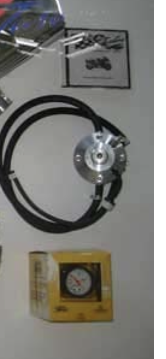

I picked up a stock gen 1 busa last spring. With plans of putting a turbo on it in the future. Well this winter a follow racer was parting ways with his rcc stage 1 kit and I picked it up. It’s a rcc kit but an older one but still gets the job done. I got it all buttoned up today. But I think the fuel pump is going bad. I got the fuel pressure set at 42 43 psi. So when you turn the key on it pumps up to that and then goes down which is normal. When it’s running it’s sits at 42 psi but when you rev the bike up the fuel pressure drops and never goes back up

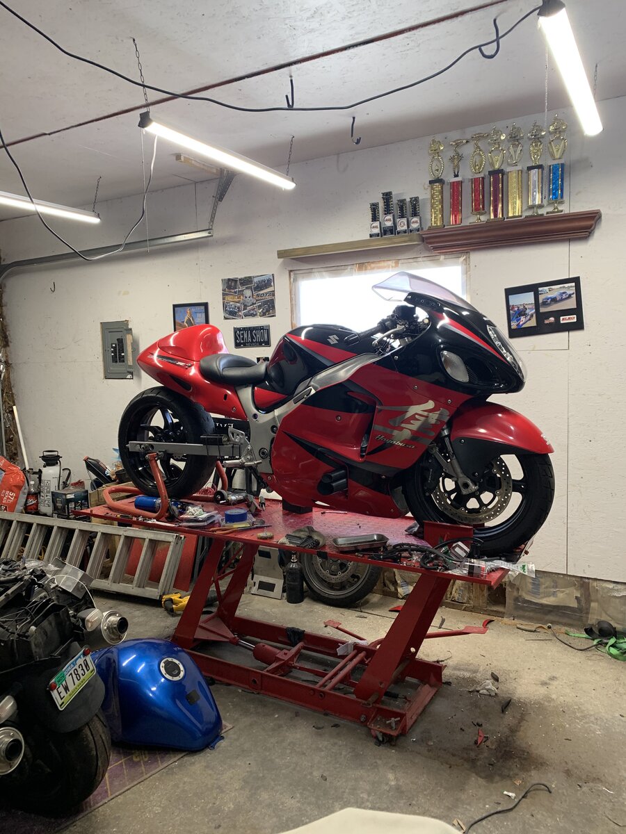

Well bike is all done and I put different plastics on it from a donor bike I picked up a couple weeks ago. Just needs a tune now. Would like to find a single stage lock up for the bike as the last bike I built for a friend the clutch was slipping at 280 whp with ape 60 lbs clutch springs.

You better peel those plastics off and send them to me! Those are mint.
