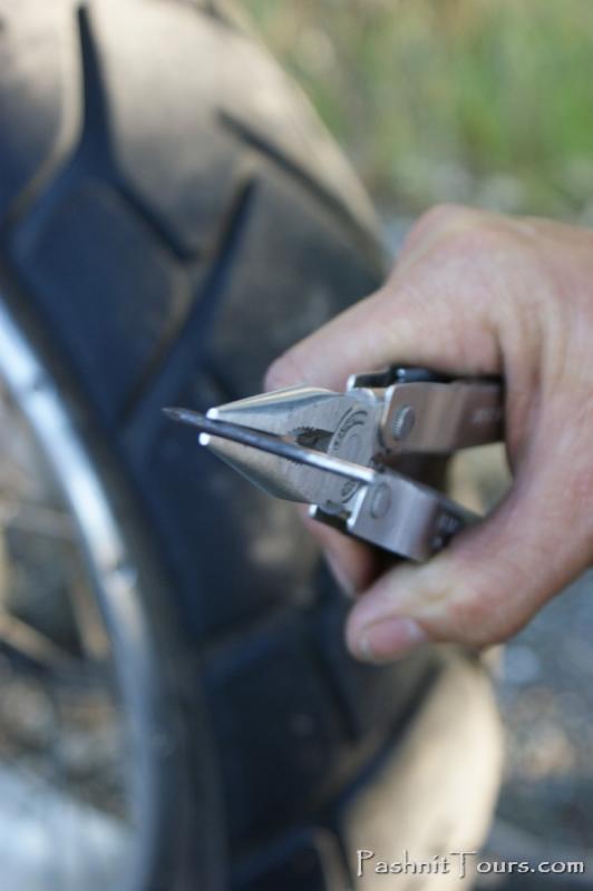

Ever had this happen? Nail in tire

I've had the same "nail in a brand new tire" issue and used one of the plugs you pull through from the inside and ran the tire like normal with no issues. Use the plug.
