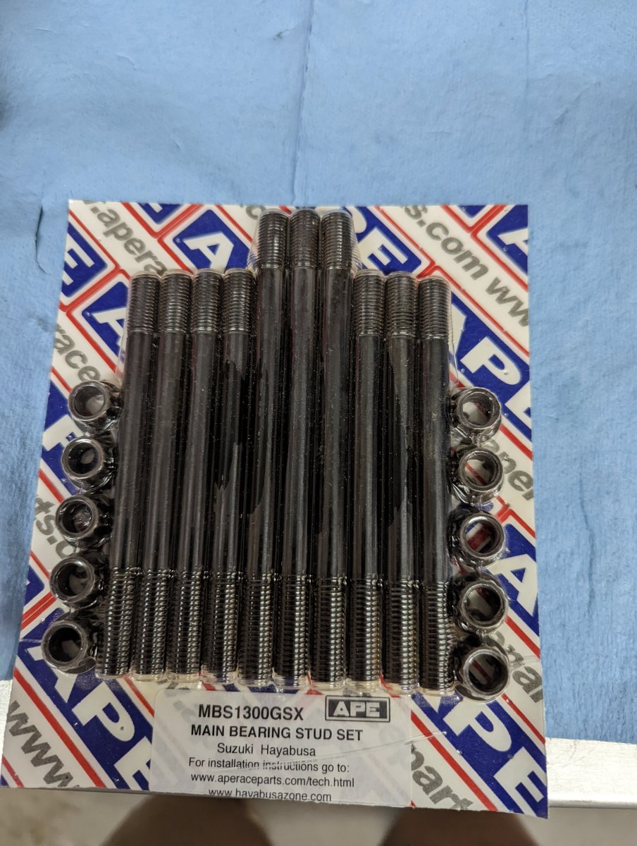

Ape for me, guess I will use the stuff they sent with these cheap carrillo rods
Did the bearings get out of round at 35lb?Perhaps I didn’t say that right. If you have .0013“ vertical clearance at 23ft/lbs (I had brown bearings installed) then pull it tighter to 35ft/lbs your vertical oil clearance will be less..... I saw about .0008” less. ARP ultra torque lube
I'm using a clymer book. Looks like I need to use a 9mm socket for my bolts. Think I can get the factory to warranty since I have 12mm bolts installed?
So your saying there's a chance.lol, I doubt it.
I think they are referencing an M9 bolt...that has a 12mm hex head.
Yeah. I read that. Then I got into all that bolt stretch from corrillio rod wrong torque spec stuff from 2010. But oe is 25 and ape is 32-35, means oe is allowing for bolt stretch? Or 35 isn't enough lb to put out round. I have oe bolts still in, going to take #'s. Then I put ape stud and see what happens.If u measure at 24, you can’t torque it to 35 and expect the same clearance. You gotta measure it at the torque you plan on using. That’s what I was trying to say. And beyond 35 distorts the bores I think jay at ape said.
I was gonna use the ape stud with the arp torque stuff (some came with the rods) but then I found a deal on arp studs cheaper, money talks lol

Bolt stretch just a myth anywayYeah. I read that. Then I got into all that bolt stretch from corrillio rod wrong torque spec stuff from 2010. But oe is 25 and ape is 32-35, means oe is allowing for bolt stretch? Or 35 isn't enough lb to put out round. I have oe bolts still in, going to take #'s. Then I put ape stud and see what happens.
