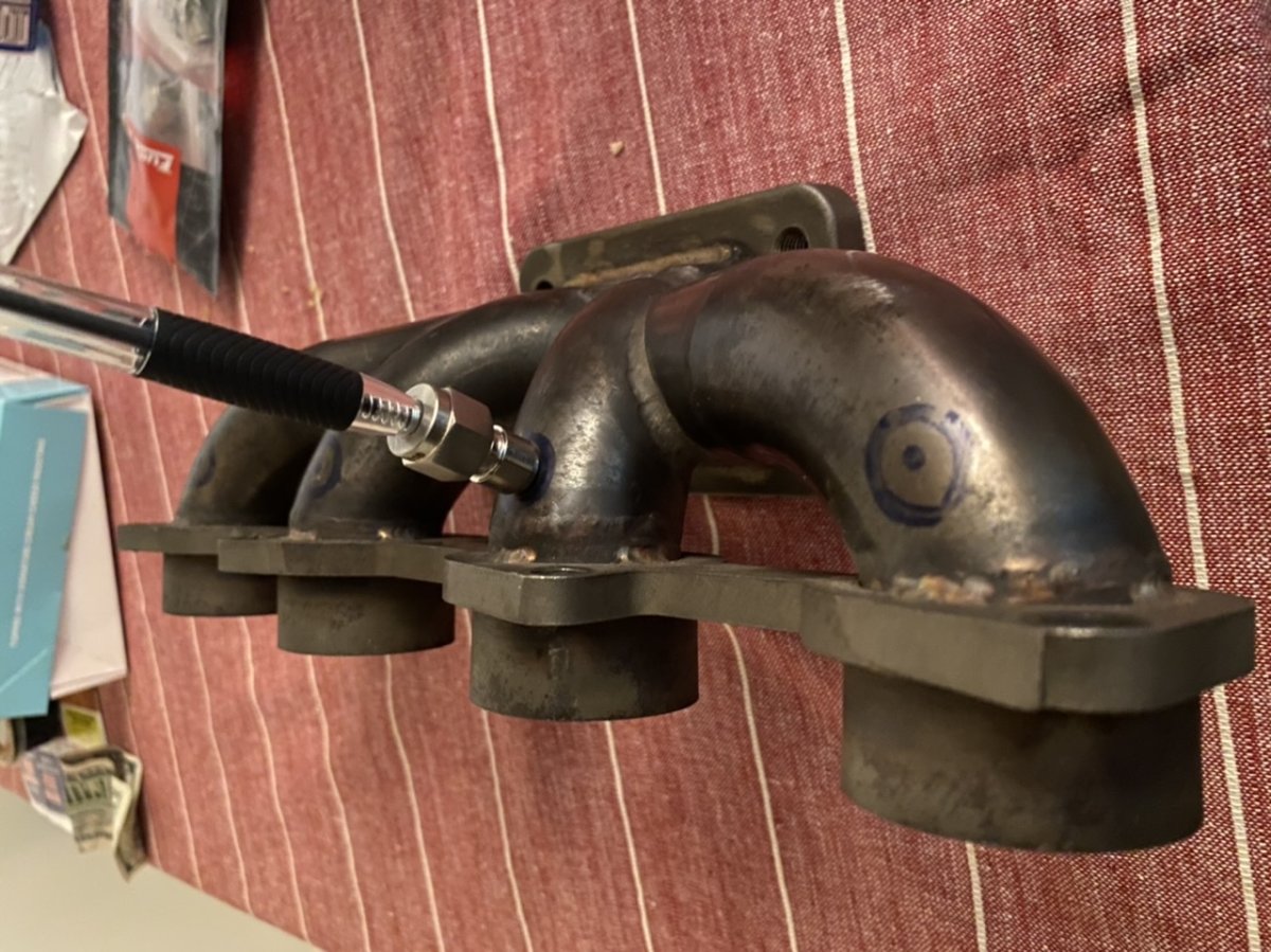

i was always afraid that that EGT sensor would degrade and put debris into the turbo.....
Supposedly it takes quite awhile for that to actually happen, usually the sensor wears out before it falls apart so I’m told. Either way wouldn’t take much to check it periodically.

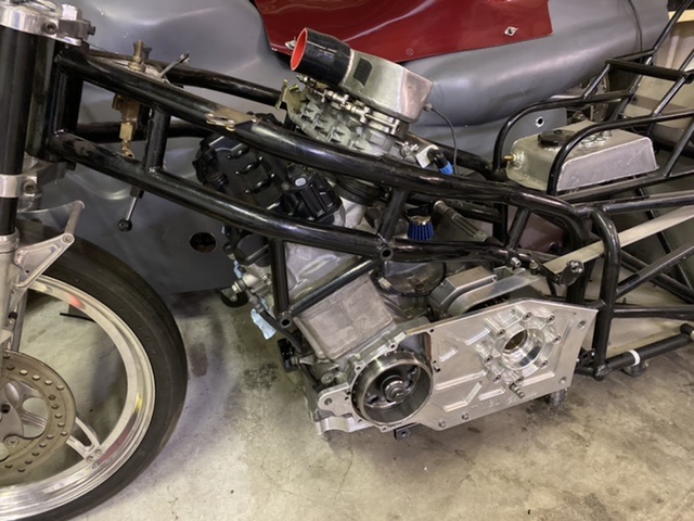

First picture-caption-one word..... for me it was “motherfuuuuuuuu$&@ker lol but I got the cams cams in and I degreed em, valves adjusted, starter, stator, engine plate, air shifter mount, everything (So far) so I threw it in the frame. Starting the new year right! Need to ream some holes and get all the engine mounts in

Looking good! What’s up with the first picture you asked to caption? I don’t get what’s up with it.
What kind of power or time are you looking to run? Looks like it will be a blast.
What clutch are you using again?

First picture has the little wave washer on top of the case, I forgot to install it lol so I had to take the whole thing apart to put it on. I only realized it bcuz I was looking for something else and it fell off the shelf haha
I’m hoping for Consistent mid 7’s at 180 without being on the ragged edge of things. It’s just a lock up clutch, billet inner and outer basket.

Tiny things I don’t like so far that probably won’t get fixed until after it runs::
I think the charge piping could be routed better, Have to make another one to fix it.
Exhaust doesn’t flow with body line, have to cut and redo dump pipe
Getting the header on was f’n annoying, an extra inch after the flange before the four pipes curve down would make it so easy to get my hand or wrench in there.
