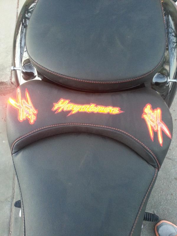

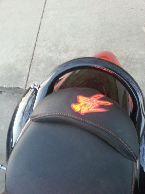

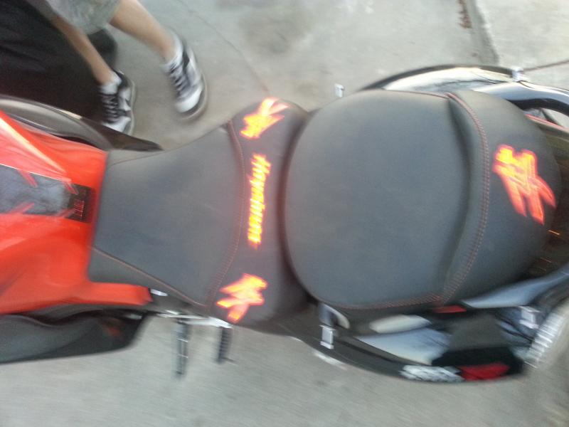

finally installed the seats tonight and they look great.the seats came with a module and remote so I ended up just hooking up to the battery to keep it simple since the remote allows me to turn it on and off. The power wire has a in line fuse come with it so that takes care of that issue.works good and the seats feel and look great could not be happier!
awesome look- wasn't what i expected... first thought was 'i know where my junk is- i dont need a light'...
but thats cool!:thumbsup:
