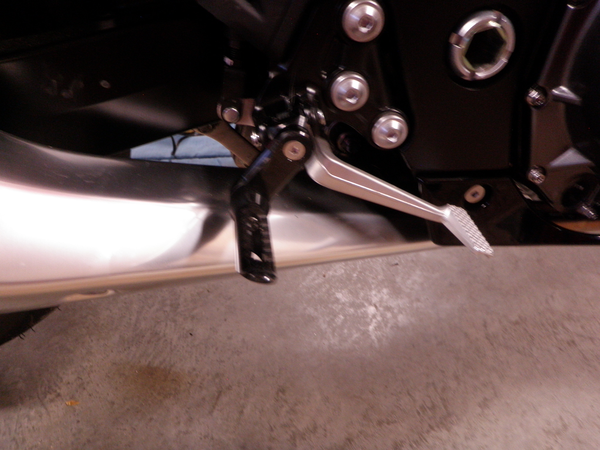

I received my lowering pegs. Looks like the screws are a bit small I may do some drilling and some tapping to increase the strength of the assembly pieces.
Interesting pin design but I'm sure they'll be more than durable for my wife's comfort and weight.

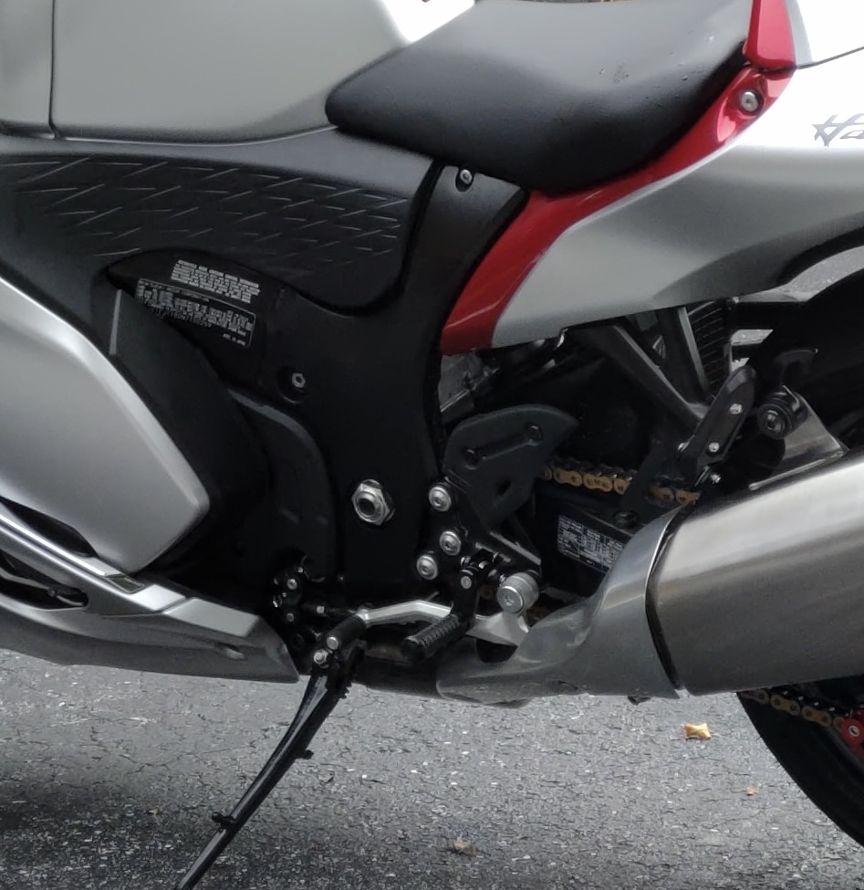

Question about lowering the pegs; I see plenty of examples where the whole peg and mounting arm is replaced, but has anyone lowered the stock pegs?
If so, what product did you use? I like the stock pegs fine enough.

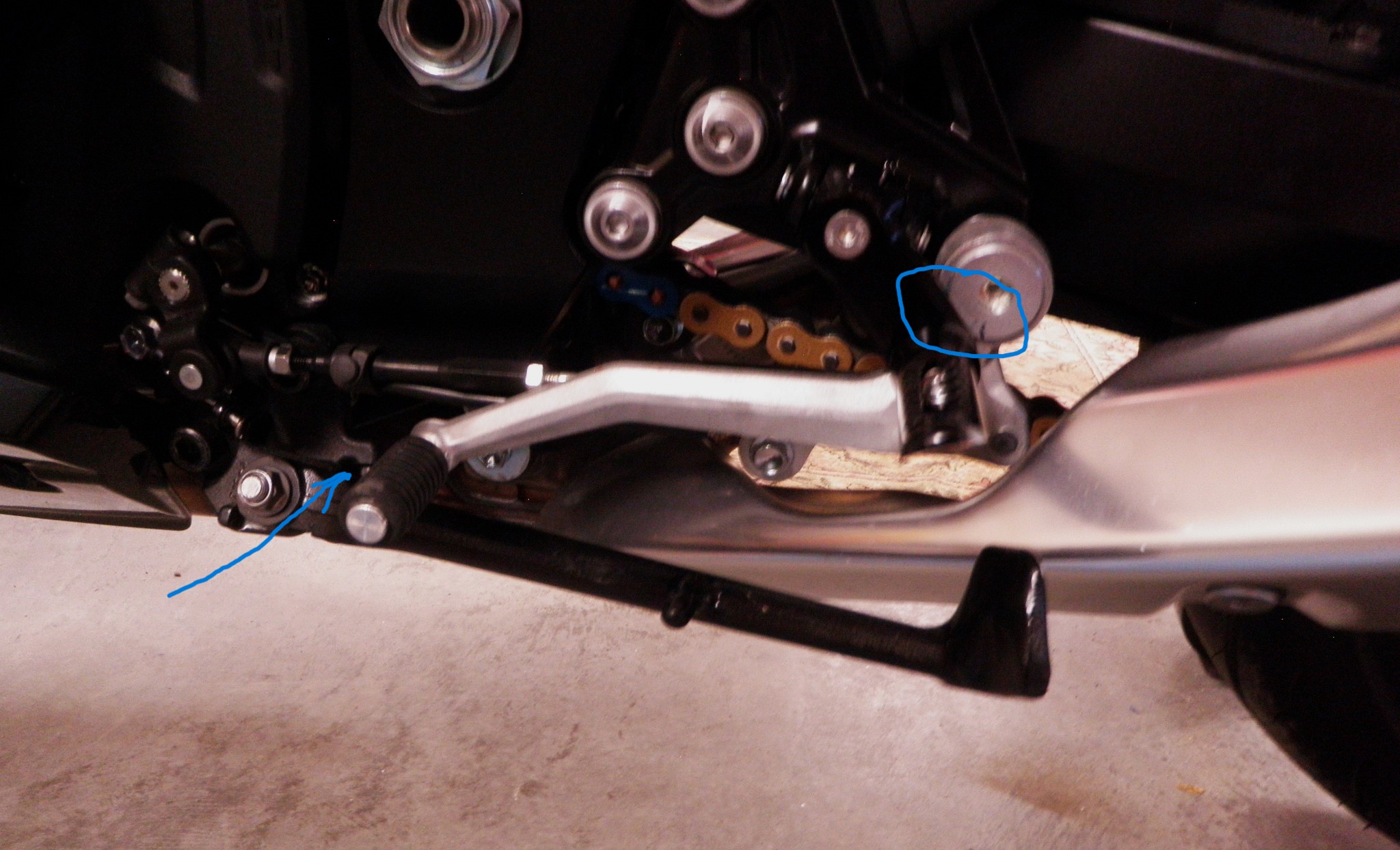

got these off ebay for a quick drop, had to cut them a bit for clearance to the shifter in the position I liked, also had to make a stop for the side stand to move it out of the way for my foot, may have to cut the little "nub" off to allow it to fold d up more like stock. Anyway a 20-25 mm drop would probably fit better all in all these are the 40mm however they are super comfortable

Man, five pages of comments and nobody has an issue adjusting the angles? If you're tall and you want the bike fitted to you for comfort, you're probably going to have issues with the shifter lever banging into the stock or aftermarket kickstand. And lowering the peg will make it worse. I've got a set of the Chinese links that are on the short side ( just under an inch I think), but I haven't put them on yet and I'm not sure I'll be able to get them to work.
There's a bolt on the kickstand that pushes in the kickstand sensor. You can lengthen it or put on a longer one and a tightening nut to hold the kickstand a little further down and out of the way, but you only have a limited range to do so. I'm pretty sure when I try these and set the angle it'll be too uncomfortable / high.

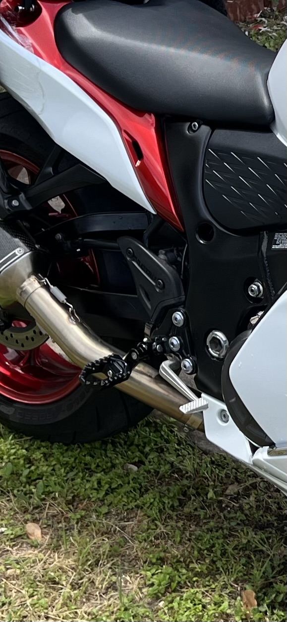

I gave the same ones, they work great although I've just noticed they are wearing into the instep of my boots...
You can buy different “M” pegs that bolt right up. I run a wide / flat set for touring that are pretty comfortable.

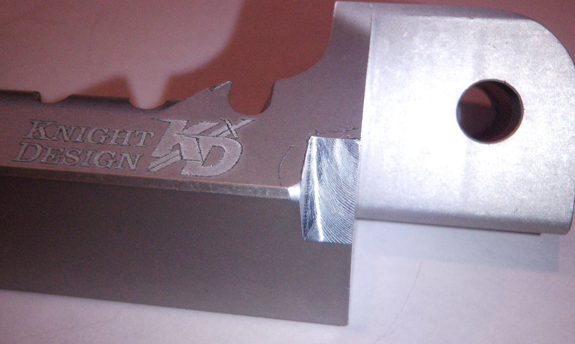

Oh on the knight pegs here is the little cut I had to do to clear, he may have updated them since then, i sent him the pics
