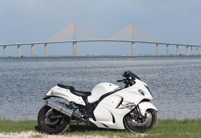

Biggest thing no matter what tire size you go with if you stretch your wheelbase make sure you upgrade your rear shock spring to compensate for it. Stock spring on a Gen 1 is setup for a 185 lb roughly rider size. Longer you go the more leverage the swingarm has so the stiffer the spring you have to go with. I only have a 190 rear tire but would have no problems running a 200 if I choose to, here is a pic of my Gen 1 stretched just over 5", with stretch, lowered 1 1/2" and with my weight being around 230 lbs I needed close to 1000 lb/in spring rate for my setup.
