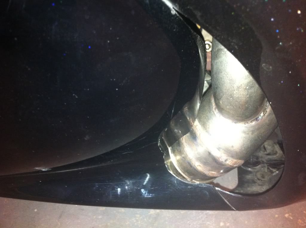

Finally had a chance to finish up cutting the plastics and getting them on all the way. PITA!!!! I had to cut a lot more than I first imagined. The "no cut" filter.....yeah...lots of cutting. The only way to not cut out for the filter is if it is like 1 inch thick at the bottom. So I said screw it and hacked away. It doesn't really stick out much. I will post some pics up tomorrow(at work) and share what I had to cut and how much.

I hope you have some heat shielding inside that right side fairing!:rulez:

Frank,
You guys sell any that I could use. It is pretty close to the fairing, so I wouldn't think the foam would work unless it was squished between the fairing and pipe.

The fairing should not be contacting that pipe at all. To be safe, you should have at least 1/2" space between the fairing and exhaust AND the heat shielding. We keep it in stock and always use it on exhaust installs.
