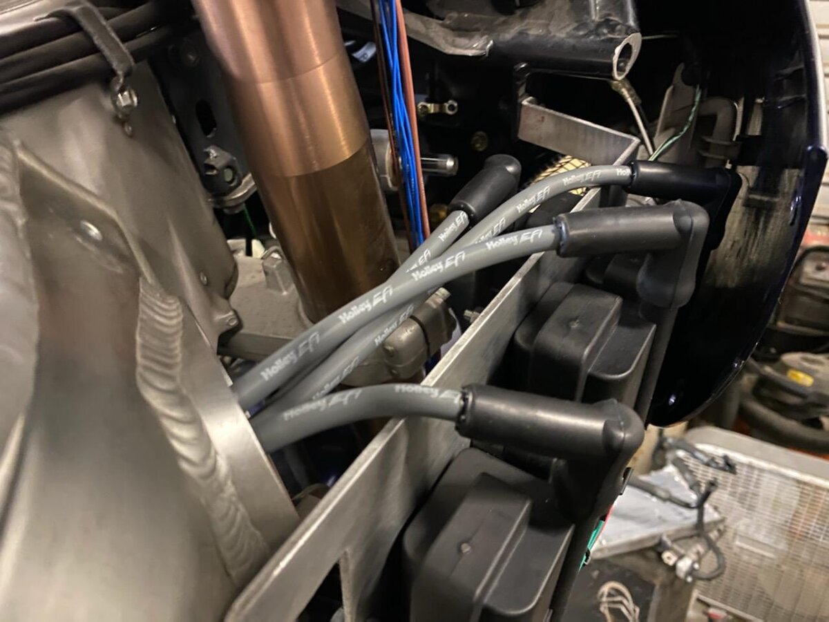

Some finished product of the bracket to hold the smartcoils.
Hi Who makes the coils? What wires are you going to run? What 8mm or 8.5mm 10.5?What I like about these smartcoils is not only do they provide crazy power to the plugs but also duration, which would help with a complete burn and might also relate to increased horsepower and being efficient.
@Boosted Cycle PerfHi Who makes the coils? What wires are you going to run? What 8mm or 8.5mm 10.5?
You can get them from Holley, fuel tech, pro efi etc. Theyre all the same coil, it just depends on who’s sticker is on it.Hi Who makes the coils? What wires are you going to run? What 8mm or 8.5mm 10.5?
@Boosted Cycle Perf Hi. THANK YOU! I am looking in to it more, I found out that only the sticker on the coils is what makes them different. I am still not sure on the wires. Do you think there may be cross talk or interference in any way?You can get them from Holley, fuel tech, pro efi etc. Theyre all the same coil, it just depends on who’s sticker is on it.
As far as wires go, just about any universal “make your own plug wire” set will work as long as the plug end is straight, and the end for the coils has terminals that would be used for an GM HEI style distributor. Meaning it has ball style terminals. I use Holley 561-114 wires.
If you plan on running typical NGK style plugs you’ll have to get some spark plug terminal nuts. They just thread on, and are needed when making the change to coil near plug so the plug wire snaps on.

Hi. If I do this I will go with the Taylor 10.4 mm wires.@Boosted Cycle Perf Hi. THANK YOU! I am looking in to it more, I found out that only the sticker on the coils is what makes them different. I am still not sure on the wires. Do you think there may be cross talk or interference in any way?
The old school theory of bigger is better in regards to plug wires isn’t that relevant anymore. Improvements in technology/materials has come a lone way since the graphite core days.Hi. If I do this I will go with the Taylor 10.4 mm wires.
