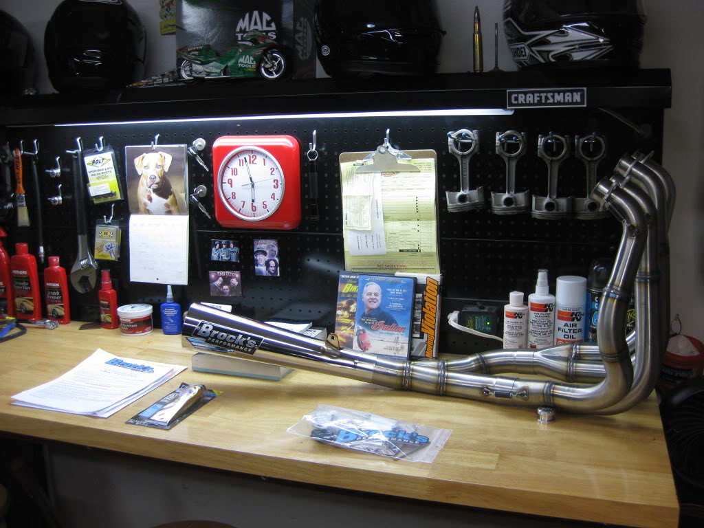

got all the parts in this morning before i went to work and pulled all the goodies out. looks good but the mid pip and the muffler pipe do not fit ??? looks like they pipe is not rounded completely and the muffler will not slip over. both head pipes fit well in the mid however. kinda disappointed bc i took a day off to do the work and now i cant. ill post pics in the morn when i have better light.

I would have slapped that header on and called Brocks. It would actually run a tad quieter that way :laugh:
