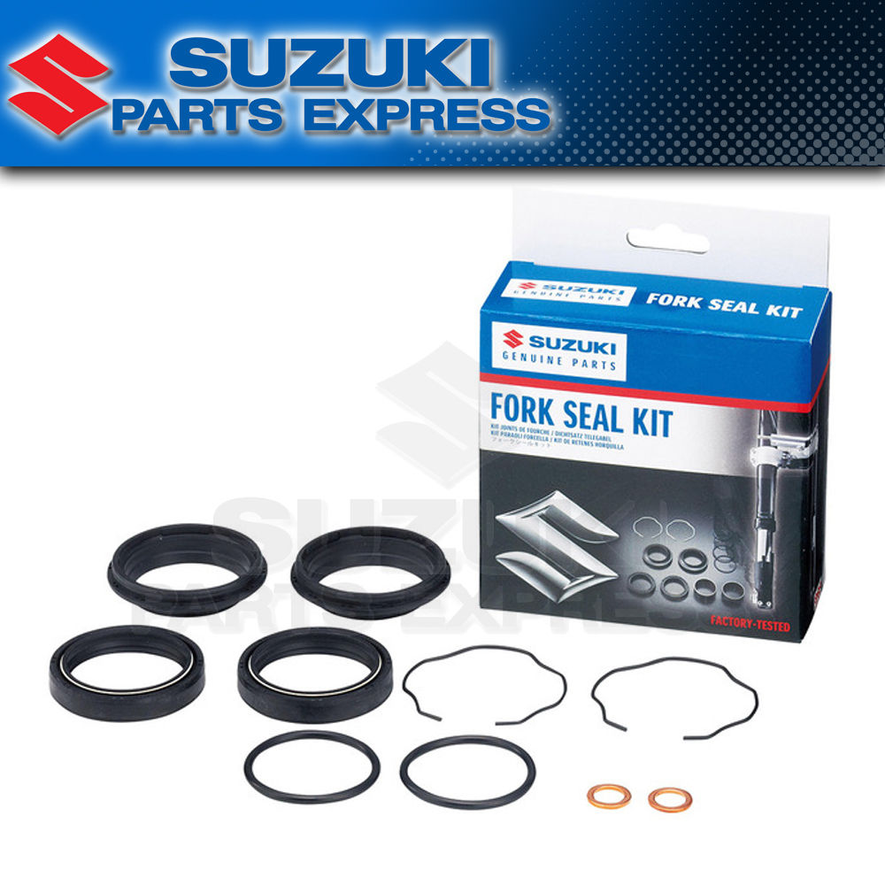

First, no way I'm going this job. I only upgrade cosmetic parts on my bike. Safety maintenance is done by the professional.
I supply parts to my mechanic. Of these 3 companies, which one do you suggest using:
All Balls
Core Motorcycle Works
Cycleto
Also, when going this job; aside from dusk & fork seals - do you need new clips/rings/garments that come in the OEM kit ?
Thanks in advance

I'm doing mine now and taking my time doing it. I purchased the o rings, copper washers, seals, and dust shields. Basically everything but the clips, all Genuine Suzuki parts.
All Balls
Cycleto
Thanks in advance
I read several comments stating OEM was the way to go, so that’s what I did. Also, the hardest part of that job is gathering the needed tools and finding a way to support the front of the bike.
