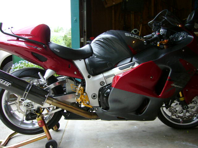

Cookie, JUST SO YOU KNOW (sorry, I was talking too loud) the whole bike is hanging from the rafters! The jack was for a tiny lift adjustment....I was switching out swingarms. Whew, talked my way out of that one!
Ray is that a Trac arm? How many over? Sorry I see it's one of C. Mikes arms.
