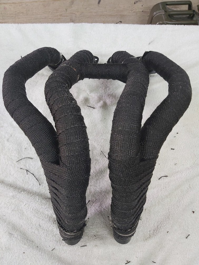

So i have been busy this morning and got the link pipes and Headers sandblasted and painted. They all look so much better now.
My exhaust wrap should be here today, so i can wrap the headers over the weekend. Just waiting for the decat H section to come.

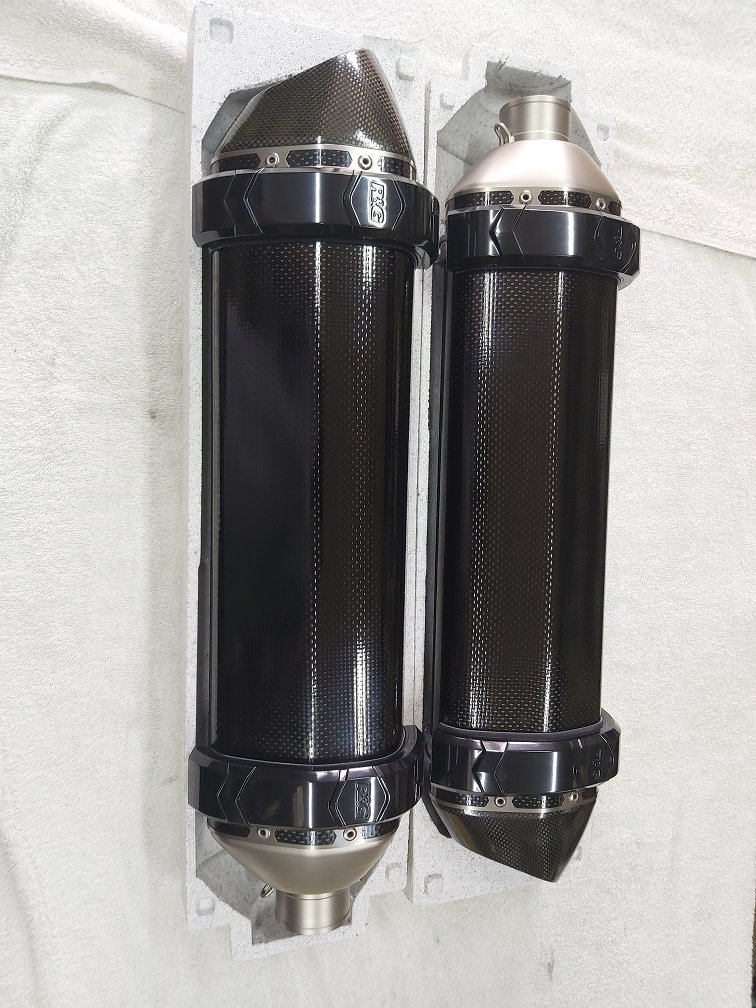

Well this morning i got the headers wrapped and the R&G protectors fitted to the carbon fibre cans. I have removed the decals from the cans, and have orderd 2 black and silver genuine akrapovic ones which i think look better than the Red & Yellow. Also i think what i have saved in weight removing the cat, I have put back on with the exhaust wrap.
As i said before i'm just waiting for the decat H section to come. It should be here in about 2 weeks.

So i now have the decat pipe fitted and wrapped. I did not wrap all the way to the end of the H pipe and also left the balance pipe so i can adjust them if needed when there fitter. I also bought a pack of 10 jubilee clips, just to add that bit extra to stop the exhaust wrap from coming undone.
The nice thing about the headers now, is they are not bottom heavy anymore, and feel lighter even with the exhaust wrap on them.
