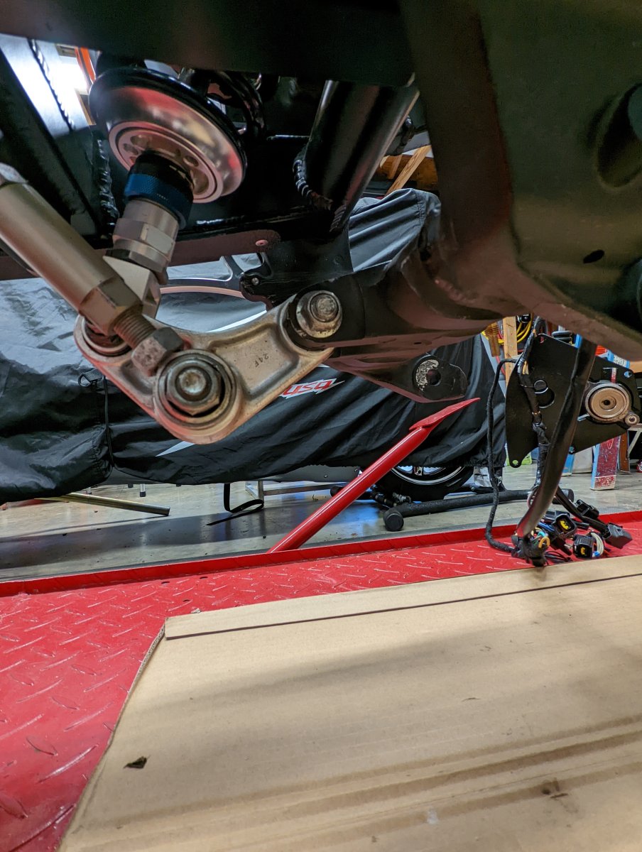

Don't go much deeper than this. It looks like you can grind it off smooth but the frame is hollow and it was notched out not added onto a solid piece
