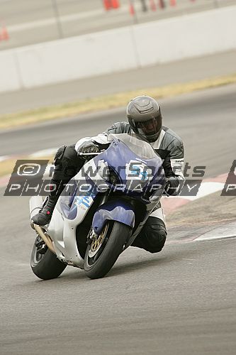

I knocked off 30 lbs:
- Stock Ca Exhaust
+ Akrapovic Ti Exhaust & Powercommander
- Stock rearsets
+ Vortex adjustable Rearsets
- Stock undetail/lights/signals
+ Hotbodies undertail w/integrated signals
- PAIR
cost around $2.5k

30 pounds? How with those items? I can understand from the stock exhaust and undertail getting rid of some unwanted (dead weight). But thats a lot. Can you give specific weight on each item please? Just wondering.

I kept a record. Give me a day to find it,and I'll list the deltas.
+ Note that I have the california exhaust so I saved around 20 lbs there (will post exact tomorrow).
+ The rear undertail/lights/signals were also very heavy (lots of metal screws and casing in that Brake light assembly) and the Hotbodies replacement made a big difference.
+ The PAIR and plumbing is several pounds while the blockoff plates are just a few ounces..

Here are the differences (to the nearest 1/2 pound):
1) Exhaust
- Stock CA Exhaust = 31.0 lb
+ Akro Evo Ti Exhaust = 9.0 lb
savings  = 22.0 lbs
2) Undertail
- Stock undertail, lights and signals = 3.5 lbs
+ Hotbodies undertail w/integrated signals = 0.5 lbs
savings = 3.0 lbs
3) Rearsets
- Stock = 4.5 lbs
+ Vortex adjustable = 2.5 lbs
savings = 2 lbs
4) PAIR
- Pair and plumbing = 2.5 lbs
savings = 2.5 lbs
Total =29.5 lbs
you can get 3 more pounds if you remove the kickstand and use a chock at the track.
I also had a bar riser I pulled that was 1.5 pounds
these two get me down a total of 34 pounds.
For the track you really want to go lighter - a turbo (see post above) wont help you on a tight track.
