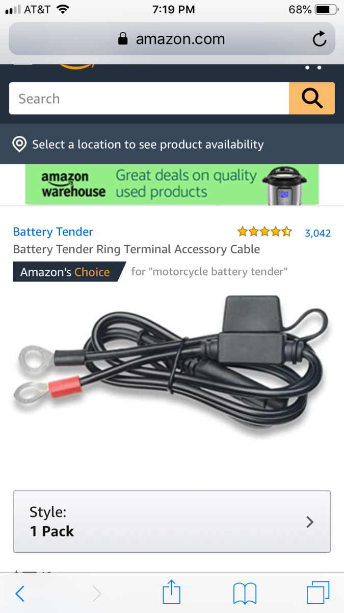

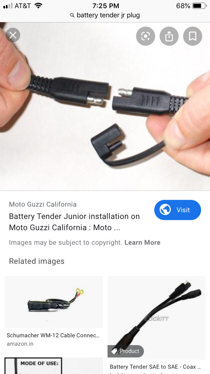

I'd get a battery tender if you have electric power where it is being stored, the battery tender comes with an attachment you place onto your battery, then when you wish to charge it, you simply plug that end into the other end that goes with the Tender. You just have to route it such that you can pull it out and tuck it back once done. The Tender charges the batter and once it is fully charged it stops and it monitors the voltage and keeps it at an ideal voltage by toggling off and on so to speak. You basically connect it the same way you would do jumper cables very easy and once connected you don't have to do anything else, you have lights on the Tender that lets you know the status of the battery/Charge. The Battery Tender JR is about $29 and THe Batter Tender Plus is about $50 either will do for your purposes. There are other brands out there as well. I personally have one of each of those I mentioned and use for car and bike.
Tached1300
So ill need to take the seat off every time I put on the charger? Thats sucks.
No you can route the attachment cord in such a way that you simply pull it out and plug it in and keep it attached to the battery. It can be zip tied to something nearby, I have mine routed so that I just pop off the rear seat and pull the cord out, on other bikes it may have been near some part of the frame, seat or other area convenient.
