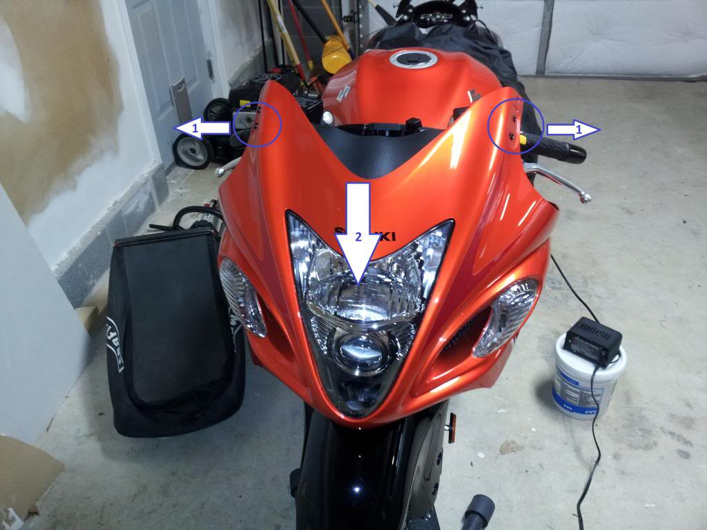

I'm about to remove the nose fairing and was hoping someone could help me out. Right now I have taken off the following:
1. All inner panels
2. Both side panels
3. All panels under the front tire (still need to remove panel right above the tire)
4. Both mirrors
5. Two screws that connect the nose to the ram intakes
6. Gauges
My understanding is that I just need to do the following:
1. Remove the remaining panel from #3
2. Stand in front of the bike and gently pull the sides over the mirror mounts.
3. Then gently pull the nose off.
Is this correct? Do I need to unplug any electrical connections such as the signals and headlight? I'm not sure if these come off attached to the nose or if they remain on the bike. Any help would be greatly appreciated.

It's been awhile, but I think you have already done way too much. You'll have to disconnect the lights, but you can do that after you have slipped the nose off a ways. It weighs nothing.
Make sure you are very careful pulling it over the mirror mounts. The Gen II is a bit thinner IMO and will tear.

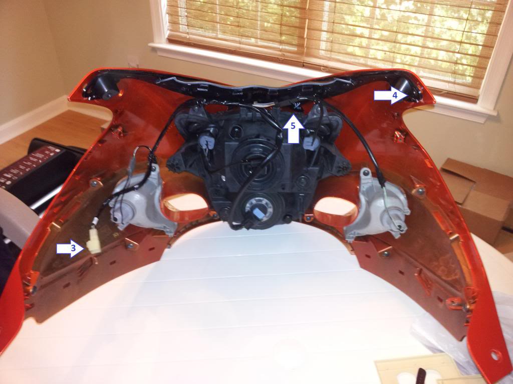

So as promised, here are some pictures and tips. Please see my previous post for items that need to be removed before attempting the steps below.
Before taking off the nose you only need to disconnect the lighting harness (See arrow 3). Now the rest of the wiring for the signals and headlamp will stay with the nose. So here is the tricky part. As you know, you need to pull the nose fairing over the mirror mounts. Don't pull from the orange part of the fairing, you need to pull from the black plastic since these pieces are together (See arrow 4). If you pull from the orange part you will break the fairing. In the 3rd picture you can see what stays with the nose when the fairing is removed. Arrow 5 from this pic shows one of the 2 mounts that hold the nose on. You should be facing the bike as in picture 2 when you do this.
Again, if you are facing the bike, you need to pull in the directions of the arrows marked as 1 until the fairing is over the mirror mount. Then you pull the fairing towards you as in arrow 2. Again, MAKE SURE THAT YOU ARE PULLING FROM THE BLACK PLASTIC MARKED AS ARROW 4 ON BOTH SIDES IN THE FIRST PICTURE OR YOU WILL BREAK THE FAIRING!
This is what the nose looks like off the bike. Arrow 3 shows the connection of the lighting harness. Arrow 4 shows the black plastic that needs to be stretched over the mirror mount (If I didn't figure this out and pulled from the orange part of the fairing, it would have been a bad day for me). Arrow 5 shows the connection to the daytime running lights. This is the connection you need to tap into if you are using the wiring harness from smithabusa (pics coming soon).
