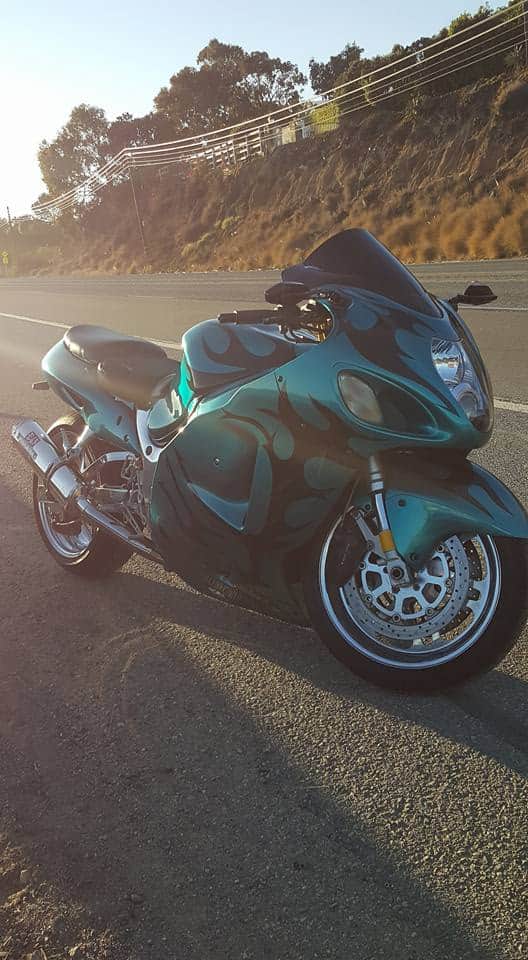

Hey all! First post and general discussion for y'all.
Background: Owned my 2000 Hayabusa Gen 1 since 2015, in 2020 the engine gave out on me on my way back home from work. Further investigation (as shown) was cavitation and a shear in my reduction gear housing. Later to find out they make sleeves for these. After some time and coming back to America in 2024, I managed to buy a 1999 Buss eBay motor. After I get done moving in a few months, I plan to drop the old motor and install the used (17k miles).
Besides labeling and marking things as I go through disassembly, is there anything else I should keep note of? I have the service manual on my phone as well. This will be the first time pulling a motor out of anything. Also, any recommendations on things to look for or install on the used motor, or the bike while the engine is out?
Currently, I plan to flush everything, replace the fuel pump, install the titanium sleeve, and replace the chain (inspect my sprockets). Once the engine is installed, I'll take it to the shop and have the fork seals replaced and get new brake pads. (Bike has been in a crate for 4 years)
