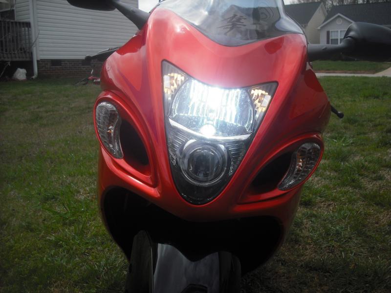

Before
https://www.hayabusa.org/forum/attachment.php?attachmentid=138758&stc=1&d=1139840818
After
https://www.hayabusa.org/forum/attachment.php?attachmentid=138759&stc=1&d=1139840974
