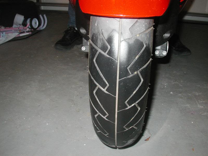

PP on the front and a PR2 on the rear. Very sticky with no slip.
+1 on this combination. I run 36-37lbs front, 38lbs rear, no grip problems at all.
Drop your air pressure some and see if that helps. Doesn't look like your using enough lean angle to be slipping any, so it's probably a sensation rather than an actual slip (if that makes any sense) brought on by somewhat over inflated, worn tires. Do some experimenting on this tact and let us know what happens.

Make sure that the axle adjusters are set correctly. If your tire is running crooked, it could have that effect.

You are WAY past the rear wear bar. You can see the wear bar in the photo you posted. You need new rubber if you want it to handle. Start there and then make other changes.

What is this on your tire, it looks like oil. Clean the oil off your tires:laugh:

The stock BT056 tires get harder as they get down to the wear bars. Like others have said, get those tires off of there ASAP.

A lot of good info....Bridgestones need warming up. Remember, the tire is cold (slick), and the road surface is cold (less potential for friction).....it's a given. :oldcool:

* One more thought, place the bike on stands and make sure everything is solid. Shake the tires back and forth, check chain and sprockets, Cush drive, bearings ...

Your tires are DEAD...old, dried out, and squared off. Get some new ones and your problem will be solved :beerchug:
