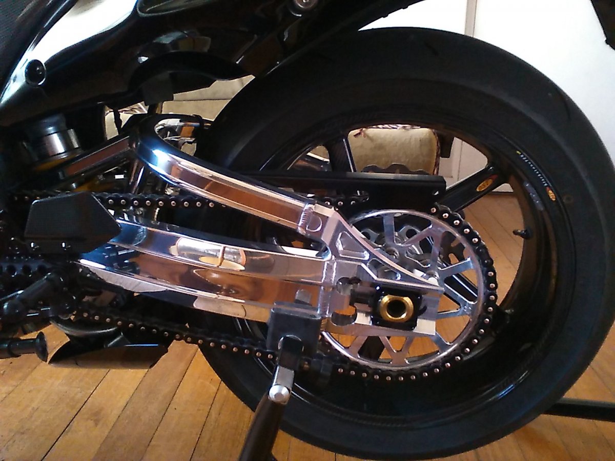

Here's the Z3D I have on my ZX-14. You might see how pale it looks compared to the sprocket. It's even a little more noticeable in real life.
I'll take a look at the zvx mate.I like the more pale gold on your 14 chain as the usual gold is a little gaudy in comparison.

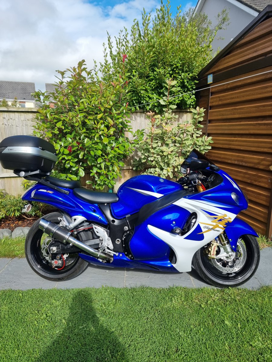

View attachment 1641400View attachment 1641401
