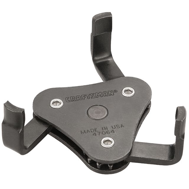

I decided to do the oil change myself, and I see in the service manual that I need this wrench. I have the oil and the filter, and now I need a special wrench just to change the filter?

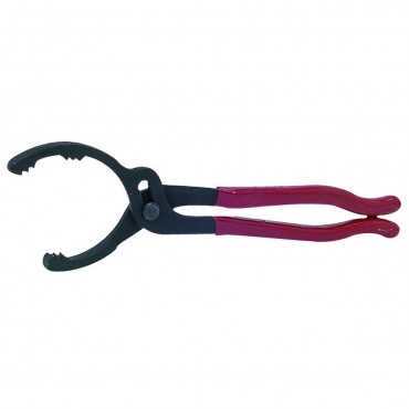

No you don't need that but you will probably, at a minimum, need an adjustable filter wrench of some type. You can get the ones that look similar to pliers at auto zone that work fine.
