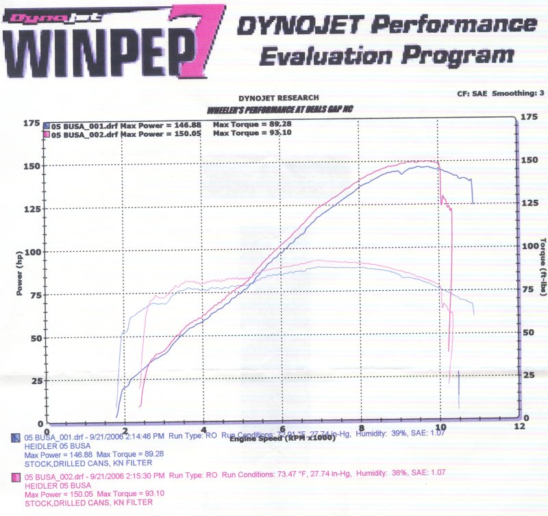

I got mine dynoed at Wheelers in NC while at the Bash. Bone stock except for the K&N filer and drilled cans.
Portable dynojet 150 upgraded to 200. 150/93 at 2,000 ft, 70 something degrees (I don't have the sheet in front of me).
A good dyno tune will help a little, but don't just compare the top number. You really need to make sure all of the mods are working together to push the top end. You should have more power earlier and throughout the powerband, which is power you really use. I'll scan my dyno sheet and put it up here for you to compare.

Don,
What I meant is that doing one mod that is good for 10 HP on its own and doing a second mod thats good for 5 HP on its own may not produce 15 HP. In fact, they may countact each other and lower the HP from what it was before any mods were done. I'm not saying that is happening with your bike, but I've seen it alot.
Gauges, you don't need no stinking gauges
Anyway, here is the printout I promised.
