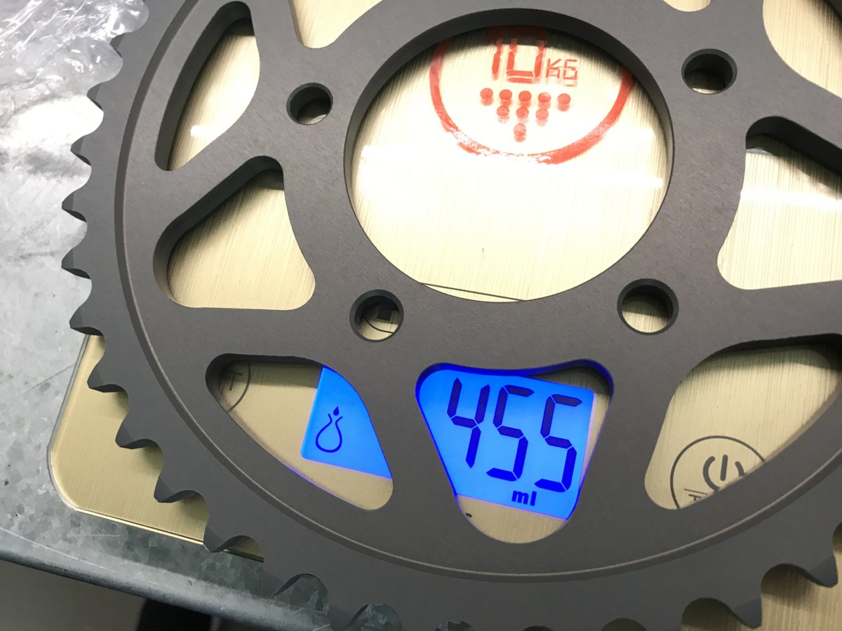

When I bought the new OZ Gass R-Sa wheels, my dealer gave me the PBR rear sprocket,made in Italy.
The PBR Sprockets, are also used by Aprilia in Motogp. As you can see in the photo this gear fits Marchesini wheels. It is aluminum and has special hardening for motorcycles with high horsepower. I bought it for about $ 75, I'll let you know about its durability, at the moment I'm just over 2,000 miles away. Its weight is 455 grams..
I have run them on last Gixxer 11 , they were fine on that bike , your one looks even better anodized color to what I remember .
