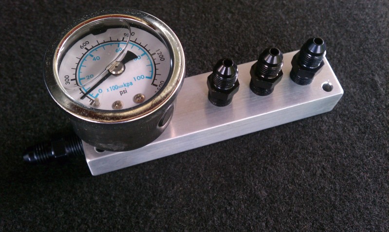

Can someone do this for me please?
lol, it's not that big. roughly the size of a 3/4" deepwell socket

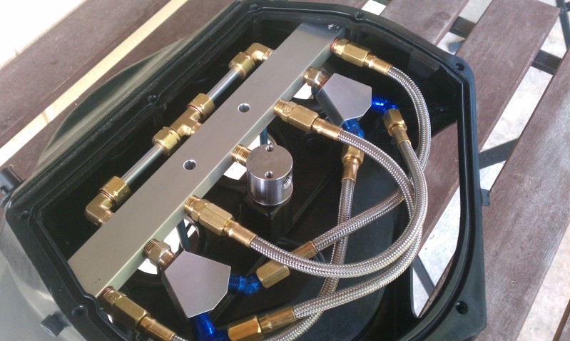

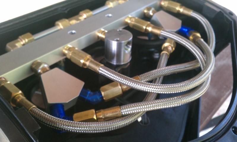

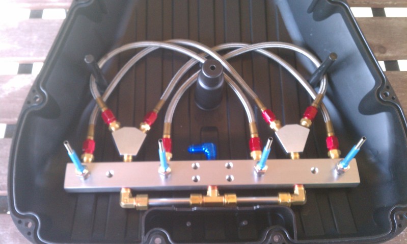

Here is my manifold for those that use nitrous to shift the airshifter

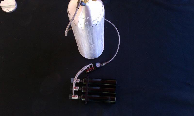

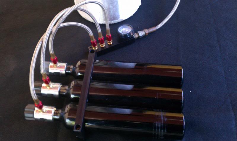

You can use Nitrous,Co2 or NItrogen to shift the airshifter. You just have to use a Co2 regulator to regulate the pressure from 900psi down to 120 to 140psi. The same bottle that is used to spray the nitrous can be used to shift.
Here is a setup that I did on a ZX10. The brass thing is the Co2 regulator. the steel braided line that is wrapped in the white wire covering is going to the spraybar in the airbox. The black poly line that is running to the rear is ging to the airshifter
