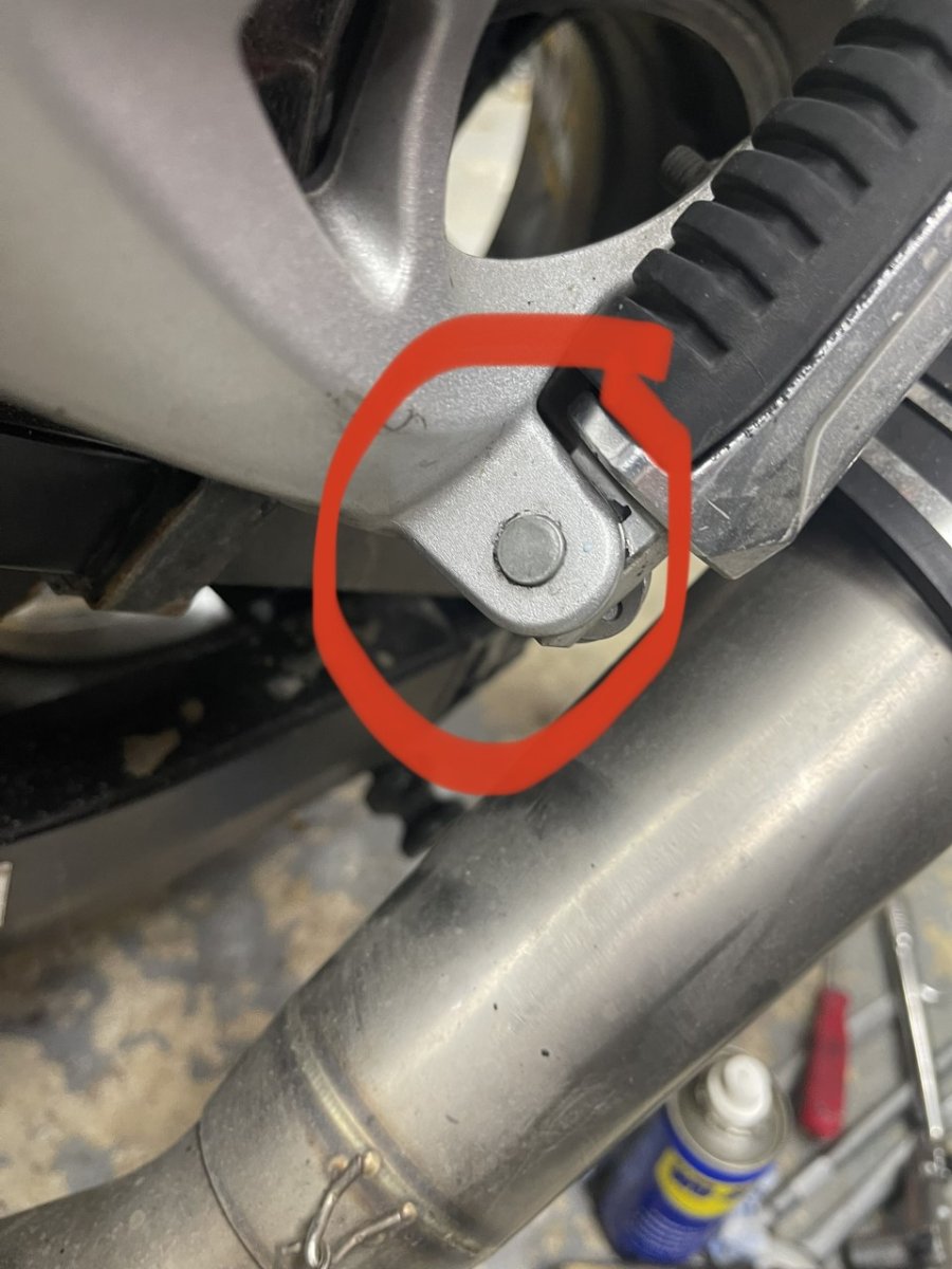

Can someone take a measurement for me please?
JohnnyDangerous
Feb 10, 2013
299
328
Guys, just fitted dogbones supposed to raise the back 25mm (1") but im not sure it has, the new dogbones were only a few mm different hole centre to hole centre, stupidly I did not measure the height to set point before. Could someone with stock gen 2 on a 190/50 take a measurement or 2 maybe to the footpegs with bike dead upright and the rear peg mount please so I can see if its higher. Thanks guys
