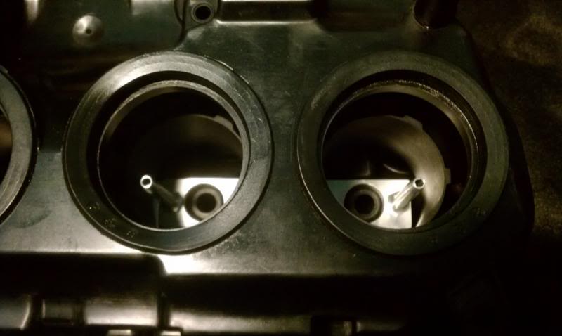

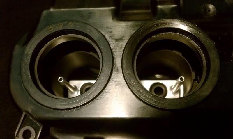

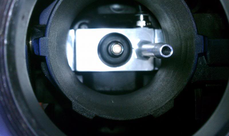

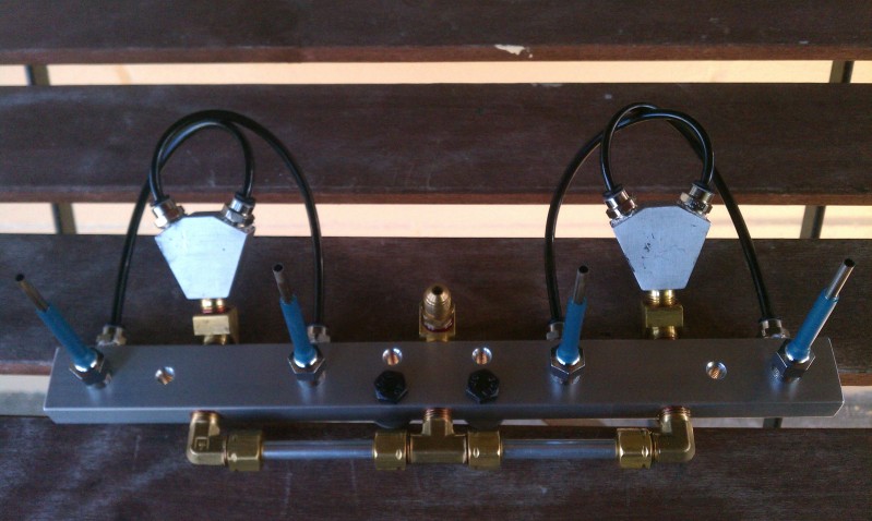

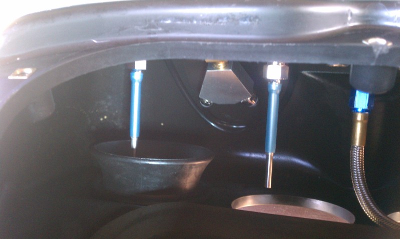

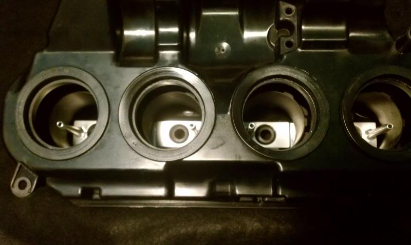

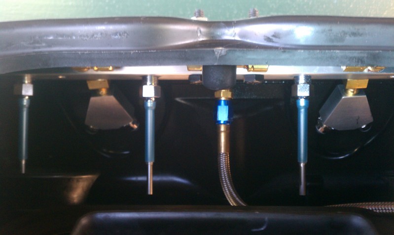

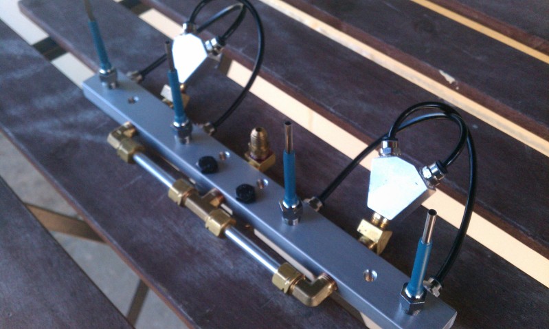

When I make a spraybar kit I purchase the airbox for the bke to make sure they fit correctly and still be able to use the air filter. No other nitrous spraybar maker would go through such steps to do so. I make a spraybar for every fuel injected bike on the market today, even V twins. Below are pics for the BMW S1000RR. It is the most complicated airbox out there. The velocity stacks have an actuator that moved them up and down. I needed the spraybar not to interfere with the velocity stacks and not block the upper injectors. The Bimmer's airbox does not come apart like the Gen 2 Busa or Gixxers. It was tough but I made it.

Dude, I love the pics, and you have my word that you have my business. I'm going to send you my airbox and get the kit from you. I trust ya bud, don't worry. If you want to keep posting pics though, I CERTAINLY won't complain!!

BTW, your rails look like works of art. Very nice craftsmanship!

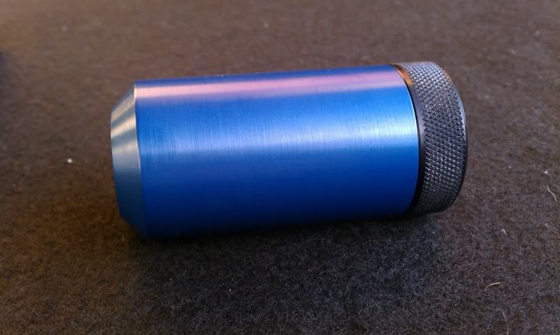

Much thanks. I also make a Nitrous/Fuel/Meth filter. Designed not to clog and more debris gets into the filter material

That looks as big as a peanut filter for a goat (fuel filter for a gas turbine compressor or GTC)
