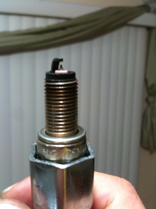

No water in airbox or near coils.
All is dry.
Plugs look ok..

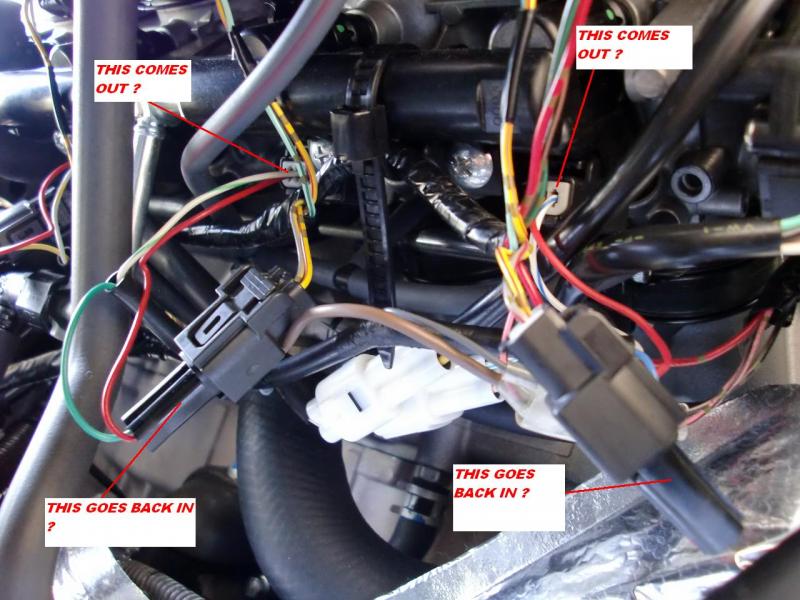

I'm believing, just a little uneasy about 'disconnecting' it.
I can see the before and after pics of install and the lower injectors it references on PC site.
Not too certain once I disconnect plug from lower injectors which I assume to be PC V plug which one I unplug from where and put back.
Also uncertain about TPS as I dont see the same red wire splicer as depicted on PC site in instructions or in manual.
The place who did work must have made a different connection.
I am gonna post some good pics in a bit so someone can photoshop it for me and tell me which plugs go back and how I would restore factory TPS in order to eliminate PC from the loop.
Thanks
Question though, once removed and if it is PC how will bike run with other mods I have done ? Will it be able to be ridden and just revert back to oem program ? Full exhaust and others without PC ?
Does xtre play a part into any of this or can that be left alone for now ?

Ok got some pics. Before I try to eliminate it tell me if I am right and please comment on if I am looking at correct area for TPS ?
Yes 2Busa bike ran fine before the wash.
Y'all take a look and I will check back later.

Not sure what is going on with the throttle position plug area... looks fishy from what I can remember it looking like. On the injector plugs you have the wrong end marked as going back.... need the factory side of the plug to go back in. You just labeled the pc plug in the pic... wish I was closer to help.
