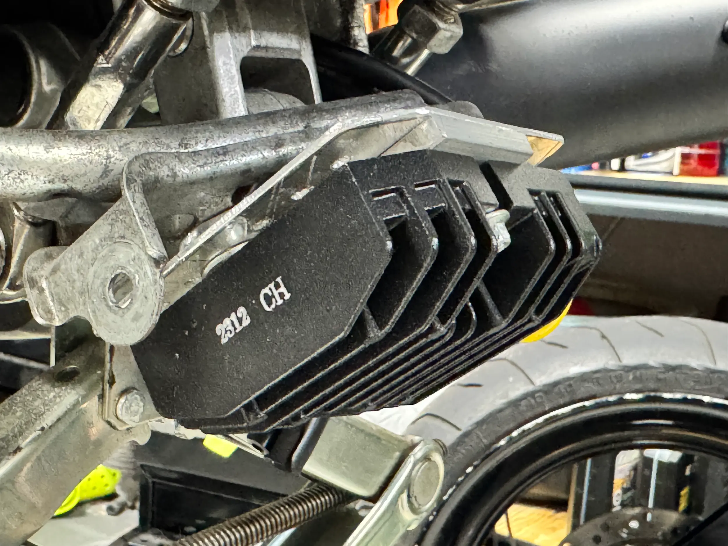

Doing some maintenance and upgrades on my bike and seeing my rectifier made me remember to come back to this thread; my bad for dropping it off. Sharing what I decided to do in case it helps anyone else.
So what I came up with was to keep it in the same location but I rotated it 90° and am “floating” it on the mount. So now the fins run lengthwise with the bike to allow air to flow naturally as I ride and to not get trapped between the fins if I’m stopped. I made an aluminum plate with about 40 small holes for more air that mounts to the original location, and then cut aluminum blocks for the mounting points themselves. So the plate is floating from the factory mount and the rectifier is floating off the plate. Still rock solid mount and air top and bottom, no issues.
Couple of pics here and I’ll look back shortly for more pics I think I took back when I did it
Hope this helps someone
