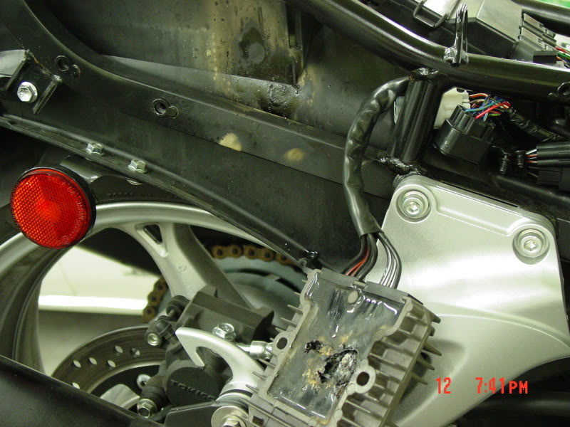

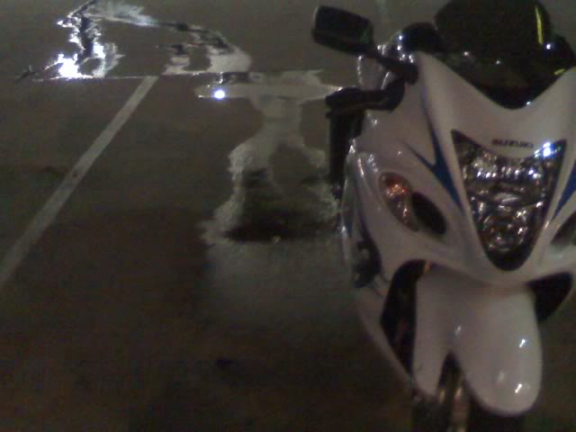

Ok,
so I get a brand new 09 with 0 miles and I relocate the rectifier onto the subframe like about 7,125,362 other GENII Busa owners have, and 350 miles later I'm at the gas station with my **** on fire, calling a wrecker and towing about 60 miles to the house.......at 2AM!!! :evil:
Yes, I said on FIRE!!
I ran into the gas station and asked the attendant if he has a fire extinguisher, he says NO......
NO FIRE EXTINGUESHER AT A GAS STATION!!!!!!
So I jog to the cooler and grab a bottle of water, trot outside and pour it down the right side of my subframe.
YEAH,
like it was gonna be THAT easy!!
So I run my fatazz right back in the store and grab a GALLON jug of water and ran right past the attendant again. This time I douched that shyte down. I saved myself a good gulp tho. By this time the adrenaline is flowing an I need a drink!!
I ain't very fokken happy about it either!
Has ANYONE at all experienced this, and if so, what was done to correct it??
THANKS in advance!!

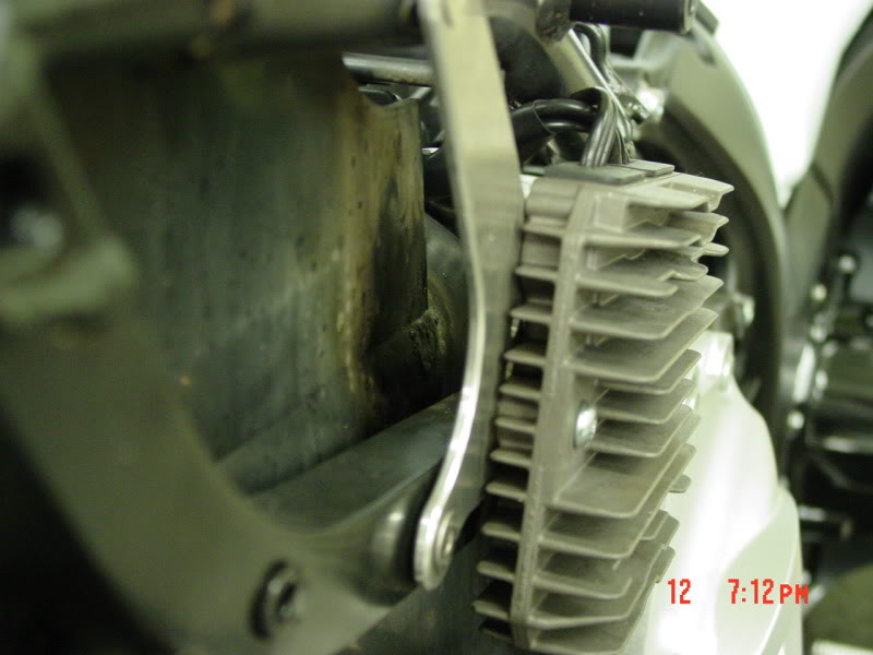

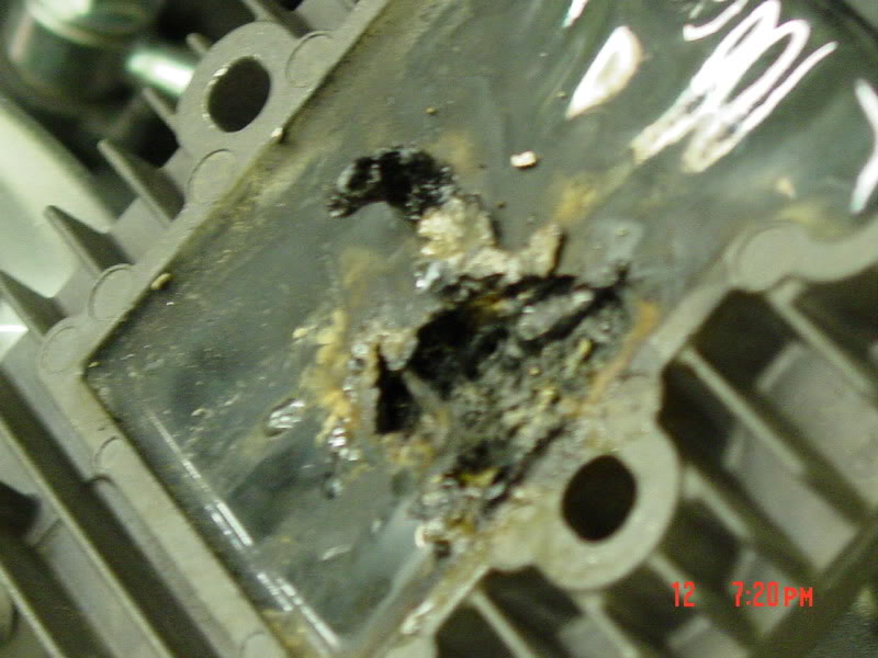

Here are the carnage pictures.
SLEEPERBUSA
May 9, 2003
1,940
17
Looks pretty good from here, right??
Well,
Maybe not so good.

NO way am I trying to say that it's not a good mod. I have read thread after thread where everyone has done this with no problems.
That's why I am asking for help.
I am leaning towards a defective part, but I am very interested if others have had a problem, and I just haven't heard about it.
fightermc
Sep 11, 2010
66
did i not read somewhere there is a recall on your model
for the rectifier now i could be wrong
m_ridgeway
pipeline trash
Aug 23, 2009
4,976
12
man that sucks i think these rectifiers need to be recalled. several have went out now we have one that has caught on fire. bunch of bs if you ask me. mine went out and i have less than 3k on my bike
vacivus
Sep 4, 2008
1,293
*sound of my jaw dropped on the floor*
Call Suzuki and have them issue a recall asap!
hemi
May 20, 2009
1,234
definitely contact suzuki, my rectifier went out 3 weeks after having the bike. Shop replaced it, only took them 2 weeks to diaganose the problem even though i told them it was the rectifier the day i dropped it off. My wasn't nearly as bad as yours, but the rectifier was a tad melted on the back side and smelled like burnt electronics. Got in touch with suzuki hq and they took care of everything
