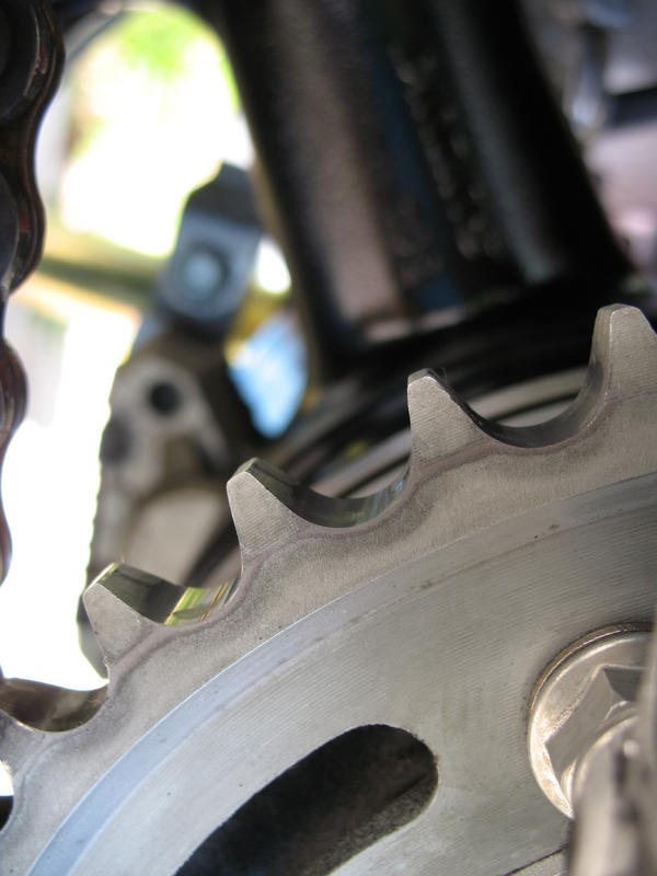

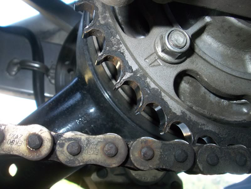

And now my mangled up sprocket:

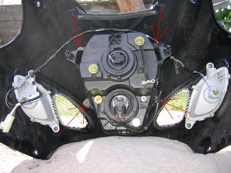

And now a question, my headlight has no support piece underneath it and sags because of it.
What can I fab, or buy that will fix this?

stock pipe,need new sprocket and chain
check ot MRCYCLES for the piece you need for your nose/headlight assembly

That bike has been pulling hard with that wear. Time for new front and rear sprockets as well as a chain IMHO. I have only seen wear like that on a straighline track bike.

I guess you like the bike? :thumbsup: Congrats bro, yep, time for new sprocket and chain. Be safe man!

Good choice in colors! :laugh: What happened to the bike? Looks like it was laid over at least once. Looks like a Hindle pipe to me, but not certain. Replace the sprockets and chain for sure. How many miles on the bike?

This is a sprocket with close to 20k on it that has been maintained.
The head lamp has no support under it, it mounts directly to the nose, if its sagging, ether it's missing screws or the mounting studs which are molded/part of the back side of the nose are stripped or broken, you might want to pull the nose off and check this,maybe larger screws or and a epoxy fix for this, the part missing underneath is just a cover. Oh and when the "key is off", everything should be "off", if the "Check Engine" light is on (key or no key) this may mean something?

+1 You might what think about replacing the "CUSH DRIVE" rubers in the wheel too. with the chain&sprockets in that bad of shape, the cush drives r prob shot! Check w/ryan from shintz racing(he's a broard sponsor) and ask about his cush drives, VERY NICE product, Great guy,and will hook a .ORG brother up :thumbsup:

Yeah I was looking at the headlight last night, and the two bottom tabs have been snapped off from the headlight casing, so until I can find a solution, I just epoxied it together and it seems to be holding pretty well.
