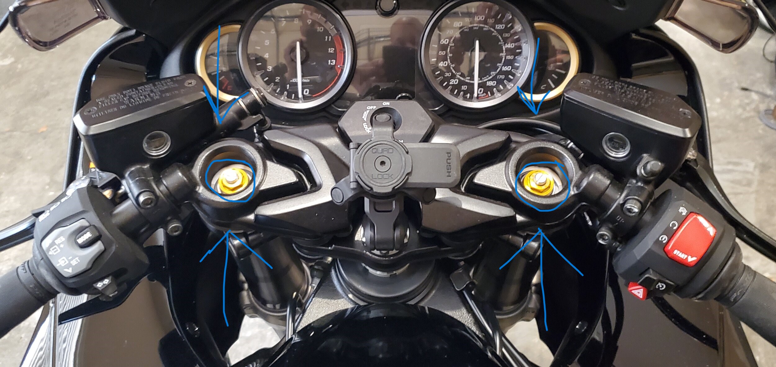

Would someone please explain what these do and how to adjust them please?
stangman327
Oct 5, 2011
1,311
877
I have the basic gist on its function but have zero experience on how and when to adjust. How do we even know its set properly to begin with?
Also what about the rear suspension settings as well...
sixpack577
Top Gun
Jun 8, 2009
23,096
34,808
The hex is preload, the flatblade inside it is compression, and there is another flatblade screw on the bottom of the fork tube, and that is rebound.
The rear shock will have a flatblade screw top and bottom for rebound and compression, and the lock rings on top of the spring are for preload.
Preload is set by measuring suspension sag, and if you are between 150 and 200lbs in gear, the stock suspension should adjust fine for your weight.
If you are much over 200lbs, you will need heavier springs inside the forks for ideal handling.
Sag for the street is average 35-40mm, 30-35mm will handle curves better but be a firmer ride.
Proper preload gets you started, then compresson and rebound are set, and can be fine-tuned on the roadside.
I would suggest watching some Dave Moss videos on youtube for a better understanding of what you are trying to accomplish, then come back here and we can help you dial it all in.
Setting suspension is trial and error, but once you figure it out, it will take your riding to the next level, as when properly set, you will have much more control and better braking as a result.
