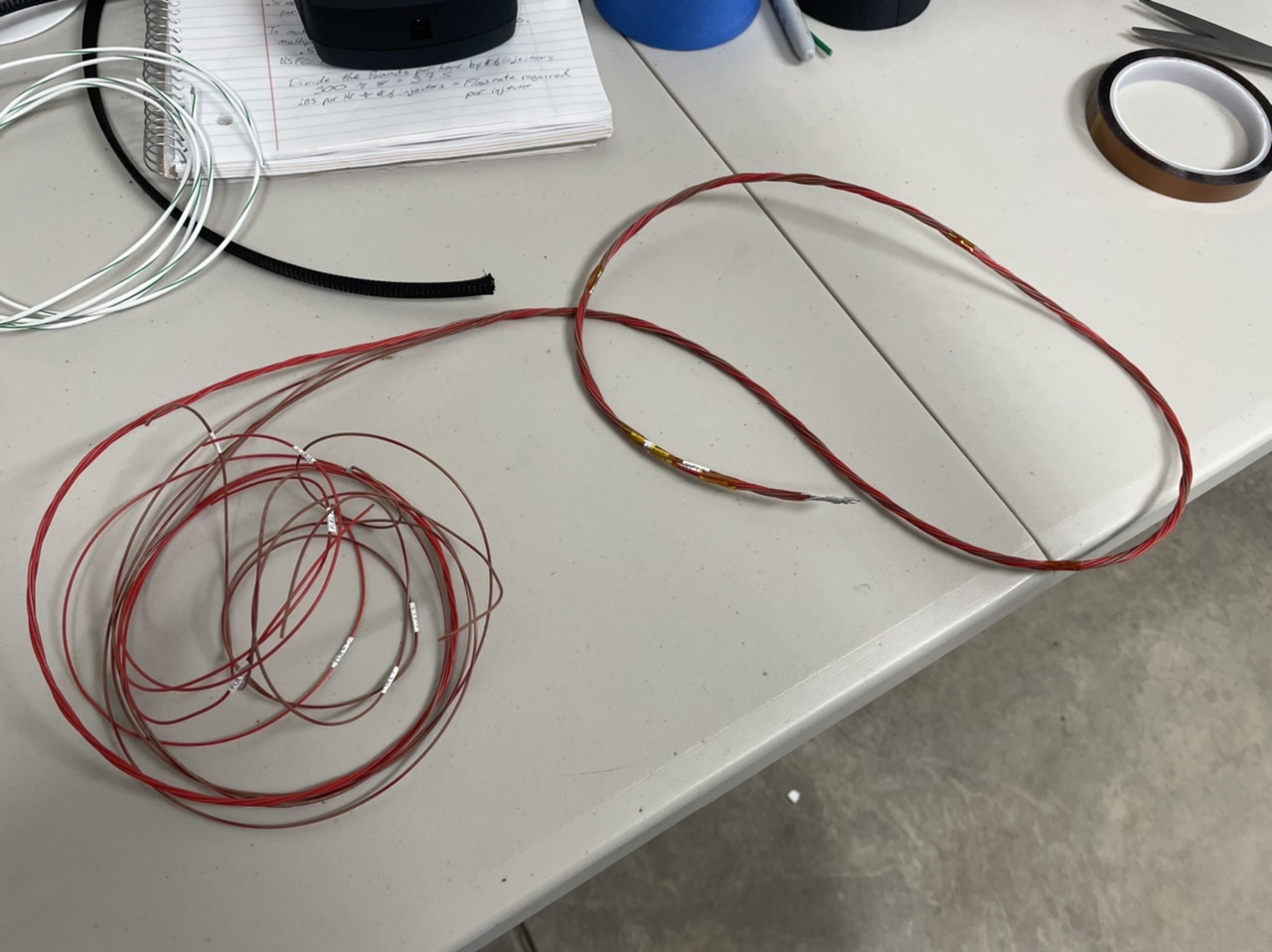

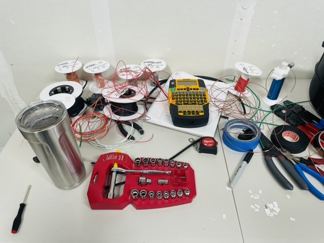

I’m wiring the injectors today and have each wire labeled.
It’s hard to see but I cut 8 wires to length first and labeled each:
Then did concentric twisting. This will terminate in the MSD relay and I’llmate it to the harness from the ecu to each injector next.

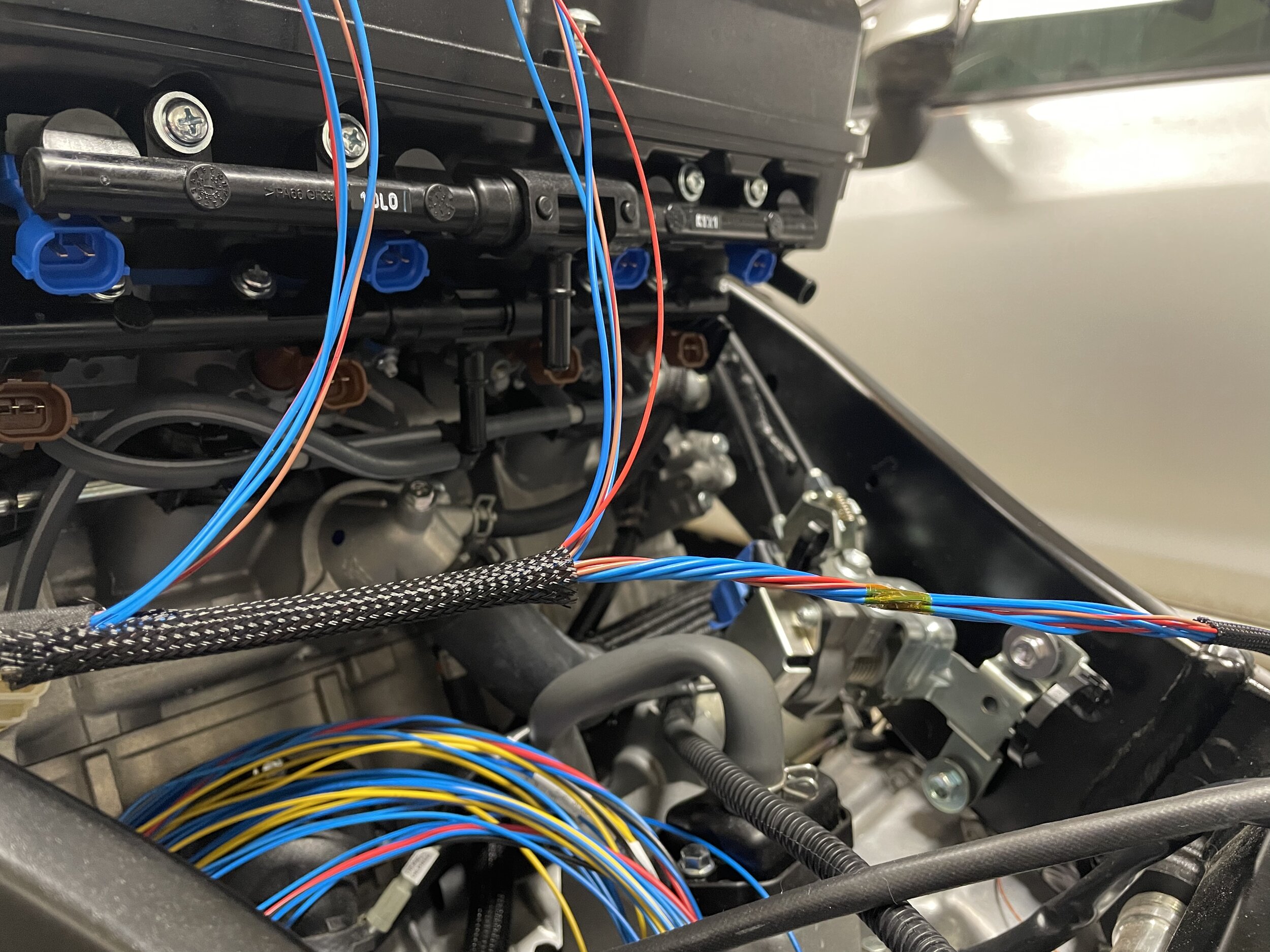

Finished wiring the injectors today. I measured the braided sleeving for the bottom pieces and not the top ones until I did cylinder 1/2. I left a lot of wire because I’m not sure where the secondaries will need to go on a turbo plenum. Also if I move the battery and relay to the front of the bike in the future I’ll have slack to do things over again.
