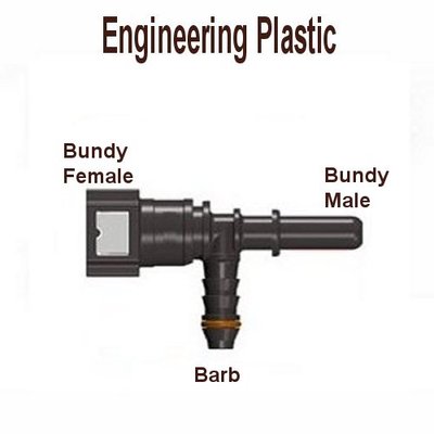

@smithabusa sorry to bother you but is this fitting I can use as a tee to get fuel pressure?
Then I can get this for the pressure sensor I believe. Is that the right size? 1/4”
I saved this picture you posted a long time ago and can’t find that thread to ask you in.

This is what I used
