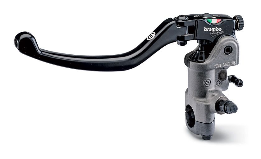

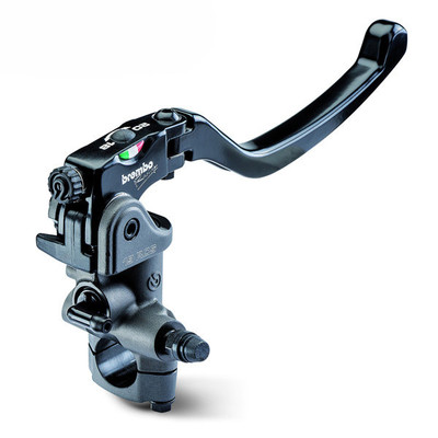

Hi @TonyM995, could you please tell me what are the Brembo parts number of your master cylinders (clutch & brake) ? I'm going to do the upgrade probably by christmas but I saw different part number for the brake.
Thanks
Hi @Armoni76 I bought my brake from Sportbike track gear who is in Michigan. This is the link but both the brake and clutch are RCS 19.
I’m not a fan of the clutch reservoir bracket and will modify it this winter.
I bought the clutch mc from Revzilla. It’s the RCS19 also and showing out of stock right now.
Yeah, you're right about the bracket, it is way too high. Can you see the dashboard correctly with both reservoir ?

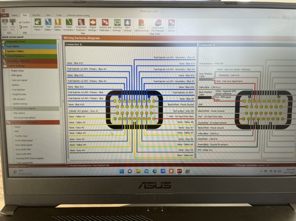

I want to wire up the entire bike and remove everything I don’t need. Then learn the Fueltech before I’m turbo; which will help with the learning curve. I’ll start mapping out all of the sensors tomorrow and hopefully be able to order what I’m missing asap.

That’s fun but what I’m actually doing is reading a stack of manuals and building out the wiring harness diagram. Not sexy at all. :)
