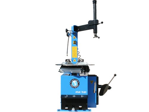

saw this for $995, not portable.. but would be nice in the garage. :thumbsup:
Nomar is a little too proud of their manual machine.

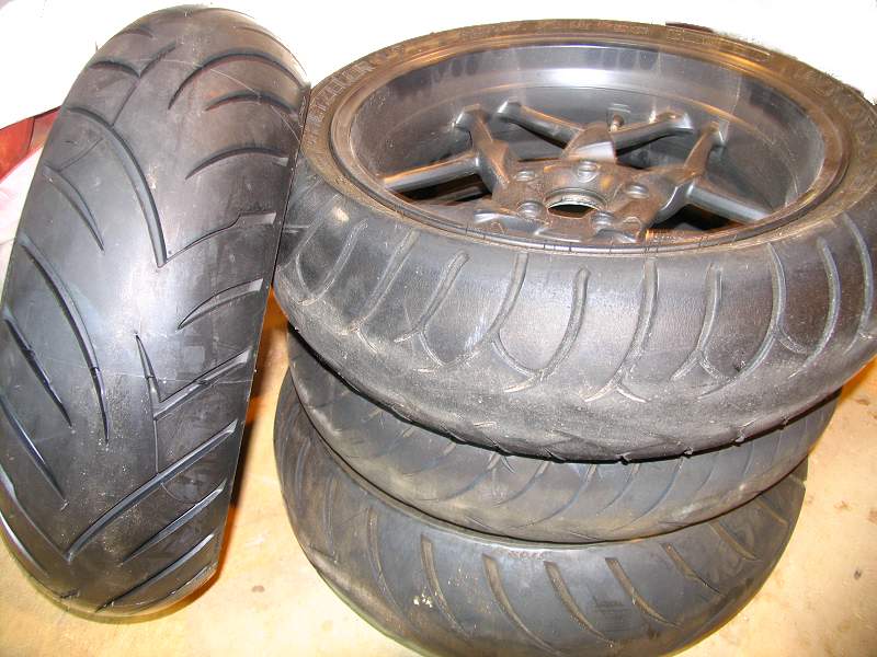

Well, I have the harbor freight set up. Now let me get flamed. Use to change the tires with a set of spoons and got tired of it so I bought the tire changer. It comes with a great little bead breaker. I didn't buy anything to balance my tires with because I have never had a balance issue by placing the tire dot on the stem, and yes I have a friend that occasionally takes the bike all the way. Never an issue. Someone told me the quality of our bike tires allows this. Flame on brothers :laugh:
