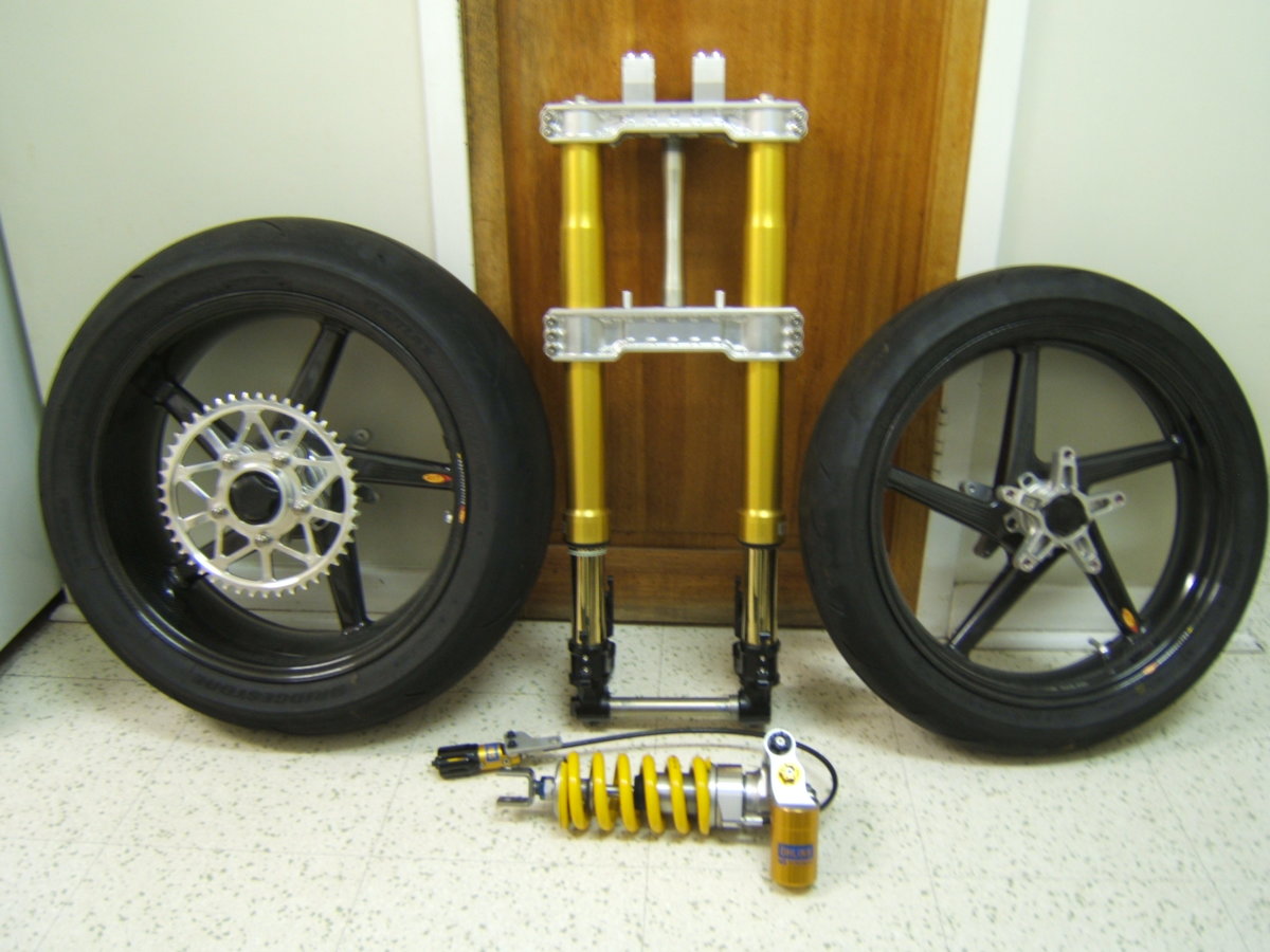

Well of course I love the BST's , but I am carbon crazy ... We were discussing this recently , about the documented failures of BST wheels , some posted and easily found on youtube , and I think those events are very few in number , when compared to how many sets that have been sold worldwide . The billet hub centers sprocket / disc carriers are beautifully machined and very strong , the cush drive is the simple individual lined rubber rings , same as Marchesini and Marvic , and you can replace the steel sprocket carrier bolt for purpose made ti bolts . Ceramic bearings are a must for the free spin gain over standard set up . The price is always going to be a major deciding factor , and like you guys have already said , the weight advantage vs $ outlay , there would have to be better value compromises or packages out there . I have owned Marvics 3 and 5 spoke magnesium and Marchesini 3 spoke magnesium also , but 5 spoke carbon ... something special for sure .
For me BST is , the ultimate ballerina spin effect wheel , light as outer and nicely balanced weighted center , is always going to be the ultimate wheel choice , absolute carbon beauties !! If you can find the $ for them , then pull the trigger on a set or 2 , like me .

Sorry for delay , had to sleep . First off , Jake , the wheels are not the R BST , actually can't remember if they were available at the time I pulled the trigger , I bought my first set a bit staggered in time . But feature everything mentioned extra on the L2 fitted set , and also the spare set .

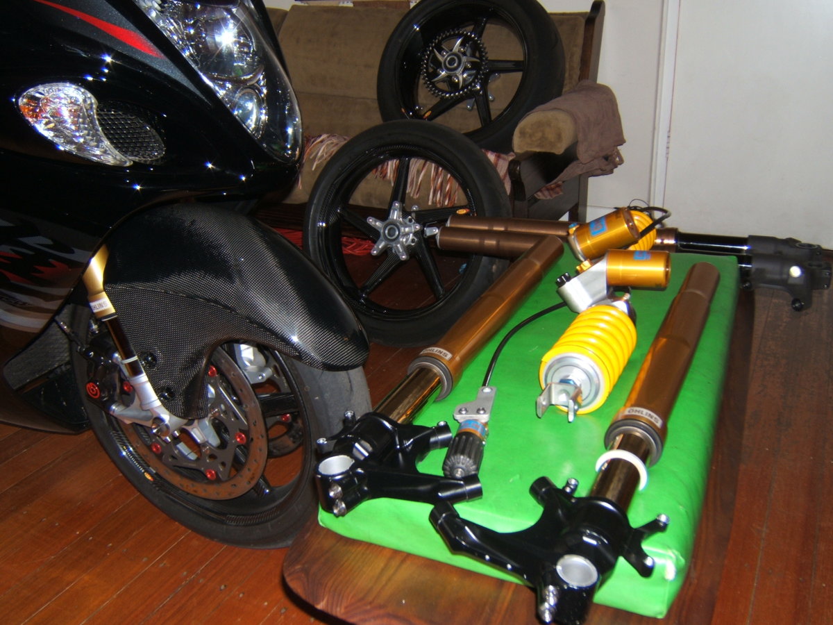

Now , one of our clan BigDev , had an unfortunate incident with his front BST , on his hyper supercharged beast , and wasn't even giving it a spanking at the time , but I believe the bike was cranked over , or at least turning / leaning in to a degree . The damage was substantial enough to have to replace it at his own expense , albeit at cost from BST . It was actually a pothole if I recall correctly . Now , I can't say I'd like to hit too many potholes straight on , let alone bang on an apex , or even at speed limit in urban jungle . Honestly , I scan road surface generally , as best as one can expect , so there is always a potential surprise ' on any Sunday ' ride . So there is still that risk , but to be honest , I have had the same concerns with magnesium rims over the years , and have been lucky . If you live and ride in an area that has neglected the road upkeep , to some alarming degree ( very possible nowadays ) , well you may want to rethink things a bit more .
Now , i run my BST front with 38 psi and the rear 38-40 psi , and my cut off ride temp is 35 degrees Celsius , as an ideal . Now I run this pressure because of my fat ass , and don't worry , they are still compliant Bridgestone RS10 , and sure footed , with some cushioning give .
If , like you Jake , you are building / built a full house motor / chassis / street weapon , not so much a swervery king or 1/4 mile killer , but still well able to effectively negotiate any streets to your favorite road locations , well even then , the BST's would be a top addition to your creation bro .
