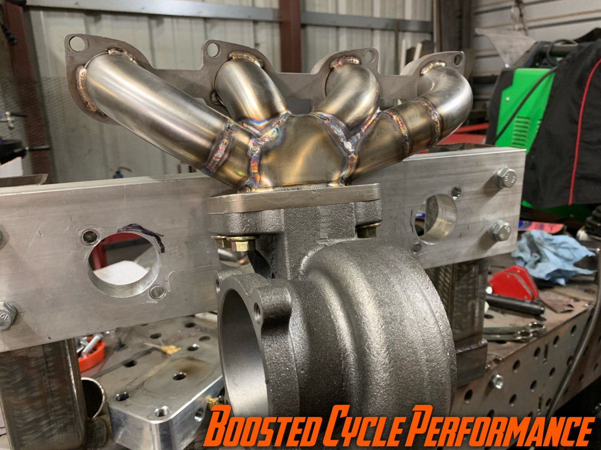

The header I made hangs the turbo in front of the engine. I guess I’m copying you on that too along with every shop that makes a header that hangs there? I’m going to make an air box out of sheet metal. I mean it’s sheet metal, and fits on a turbo hayabusa under the gas tank. You used to make them that way. Am I copying you on that too?
Honestly I hate being a smart ass about this, and hate to see you’re upset about it as I’ve been selling and supporting your products for years. Hell I’ve even put my foot in my own mouth standing up for your products when I wasn’t aware of the recent turbo change recently if you remember.
No doubt it’s a good place for a pump. And not many ways you can change a little bracket. But I sure as hell didn’t lay a piece of paper over your bracket to make mine. I took some measurements of the shock mount, drew one up in Fusion, and cut it out on my plasma table.
