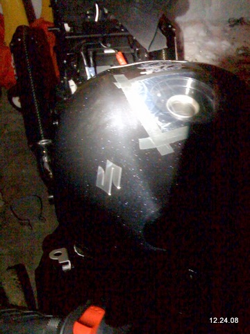

Here are some pics......just used a heat gun......heated it until the "S" bubbled alittle.......pulled it off......and pulled off the remaining glue while still wamr with fingers and ........ VOILA!!!:thumbsup:

Would it be easier to heat it, then slide some fishing line under it to cut the seal? Would it come off in one piece? You guys have me thinking now...???

lift the edge, spray with decal remover, they come right off in one piece.

i will be taking mine off tonight. i have a special tool that i used to remove the badges off my car. i should be able to get them off in one piece. who ever wants them pm'me your address and ill send them out.

I used a hair dryer and dental floss. Some residue was left behind but was easily scraped off w/ my thubnail.

Use WD40 and saw it off with fishing string. Then use the WD40 and a soft cloth to remove the rest of the glue.
