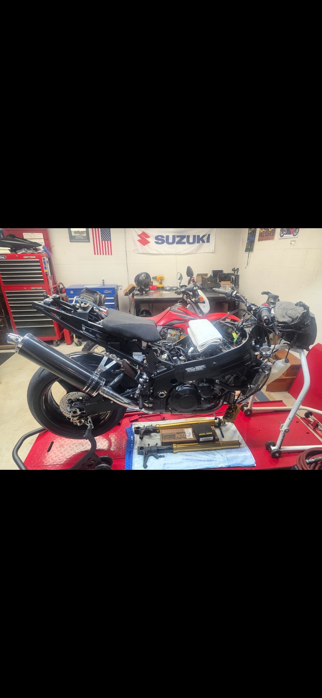

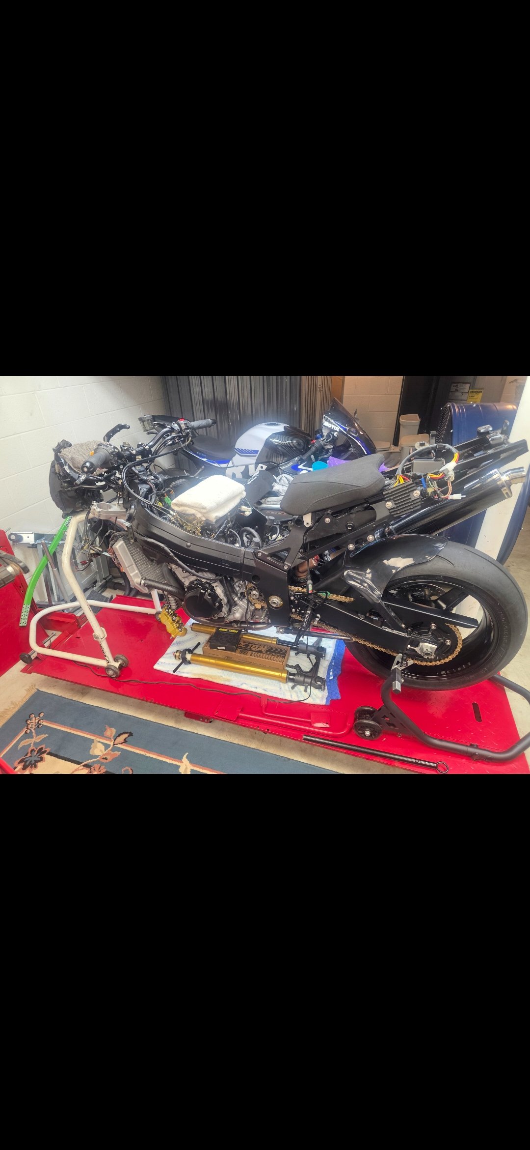

Heck, I've seen some of your posts when you were elbows deep in the GSXR transmission.....a task I would be very hesitant to do myself but you not only ripped into it, your work stands for itself...
This forum definitely needs people like you who add your experience and expertise into the mix...
We are blessed here and have many such people.......I believe this forum would eventually cease to exist without the expertise of people on here guiding others in repairing and modifying not only their Hayabusa but other bikes and vehicles....
Speaking of your GSXR.........what is going on with that thing?

As for my '03, lol...I just currently havn't had the time, and when I do, I lack motivation, lol
Sadly, most everything is there, I just need to get moving again.
As it sits, the forks are almost apart, and on the bench.
I took their caps off and springs out a few weeks ago(to put in RaceTech springs and Gold valves with new seals)...then that bastid Murphy showed up...and the lower fork bolts just want to spin, even with an impact.
So, I have to put the springs back and caps on in order to get those bolts out.
The only problem is I need extra hands with this pair specifically.
They felt stock riding them, but of the many I've done, I've never had springs be this stiff and tall before.
My friend with the '18 Gsxr helped me get them apart, as he has several before, and even he asked what was wrong with these, lol
So that was enough for one evening, and he'll come back whenever I need him to.

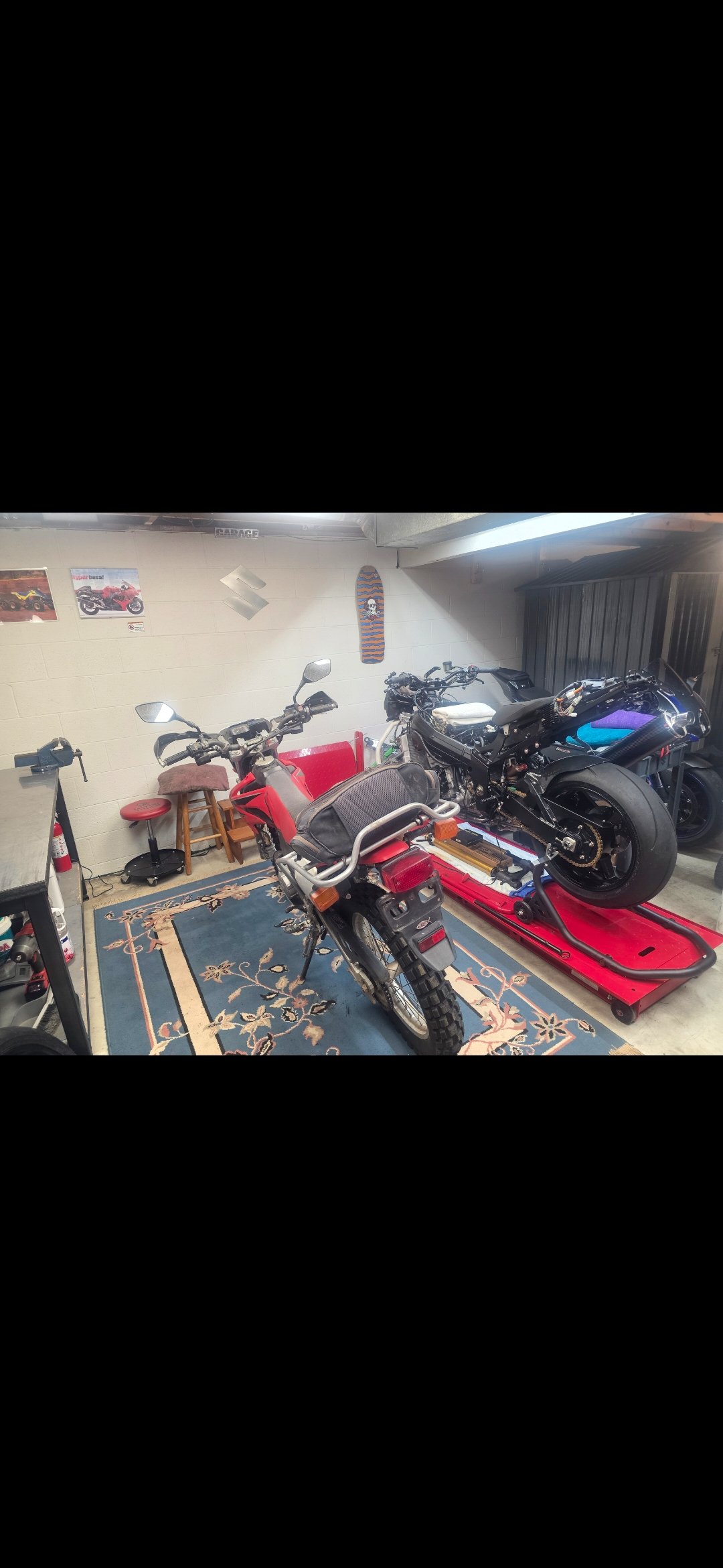

It's still warm here, but the days are quickly getting shorter. As it cools off and we have less daylight, I'll get back to it.
Somehow I Always seem to buy or finally fix bikes...when it's good and freezing cold out...which makes for great test rides, lol
This is what my workshop looks like at the moment(The crf230L ds needs a shifter oil seal, $4...and it's sitting on the bench too)
