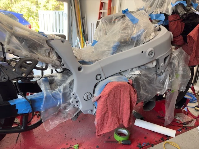

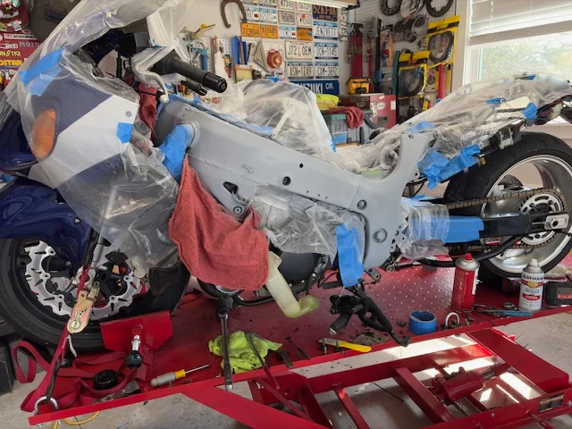

Thanks guys...here's some pics starting w how the bike "was" before I started my craziness lol

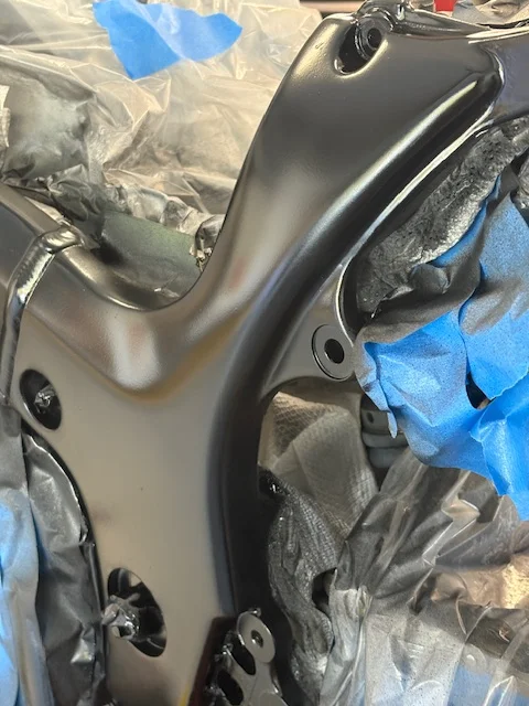

Thank you. I decided at this point in my life that a properly done rattle can paint job will suit me just fine haha.
Sold all my hobby-level paint spray equipment,gun,etc and my 60g compressor before we moved so Rust-Oleum was my only plan from the start:D

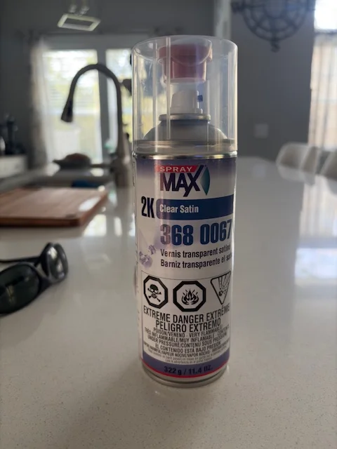

Bought a pricey can of this stuff but on the fence if should even bother w it or just wet sand between coats like Ive been doing and call it a day without the clear

Rustoleum makes a great product....I've used that to paint some bathroom fixtures and so far so good after 10 yrs......
It would probably be good without a clear coat....

Be careful putting the Spray Max over Rustoleum. I believe Rustoleum is enamel and Spray Max is urethane. The clear *may* anger the enamel paint and give you your wrinkled look back.

Thanks both of you,after reading a bit deeper in AI about the Spray Max I decided I'm not using it. Sounds like I'll definitely F something up according to the directions and do's/dont's posted online :laugh:

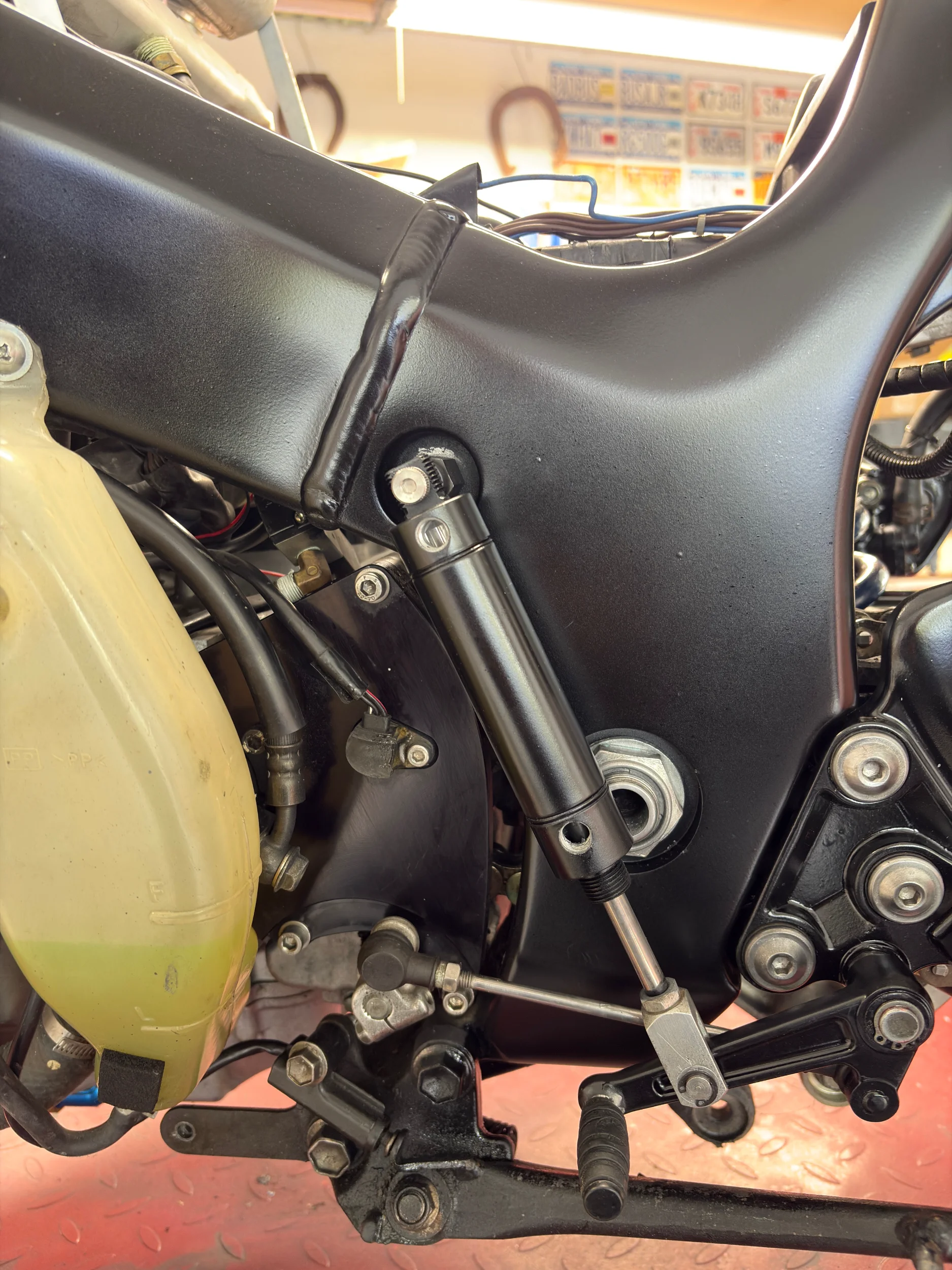

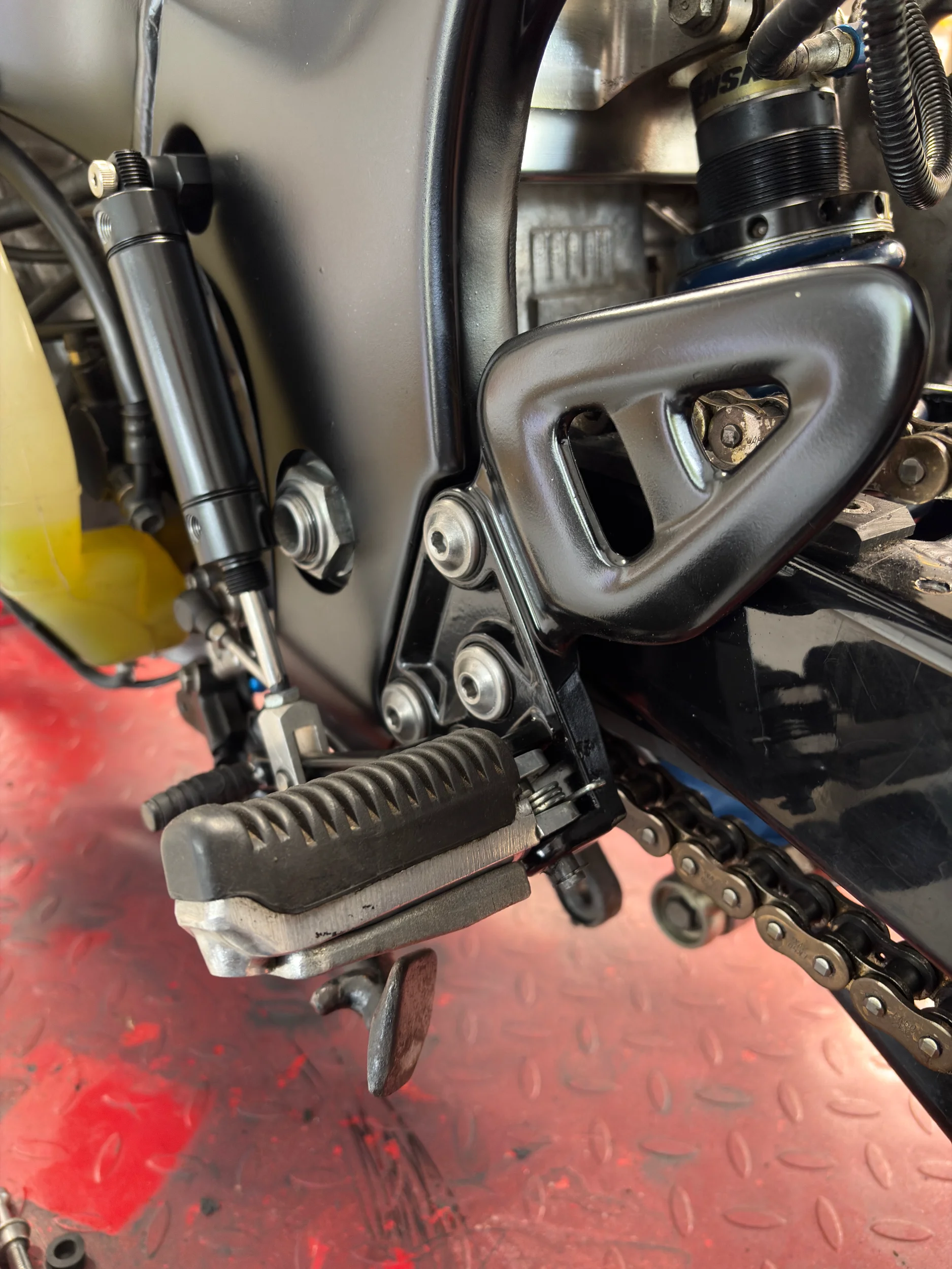

Ok so paint has dried,the foot peg brackets,brake pedal/MC,shift lever,air shift cylinder etc have all been painted and bolted back on after taking the wire wheel to all the bolts and nuts to get rid of any oxidation etc. AntiGravity battery arrived along with all the air shift supplies
It sure doesn't look like you did it with a rattle can...it turned out great and I bet it will be durable too....
