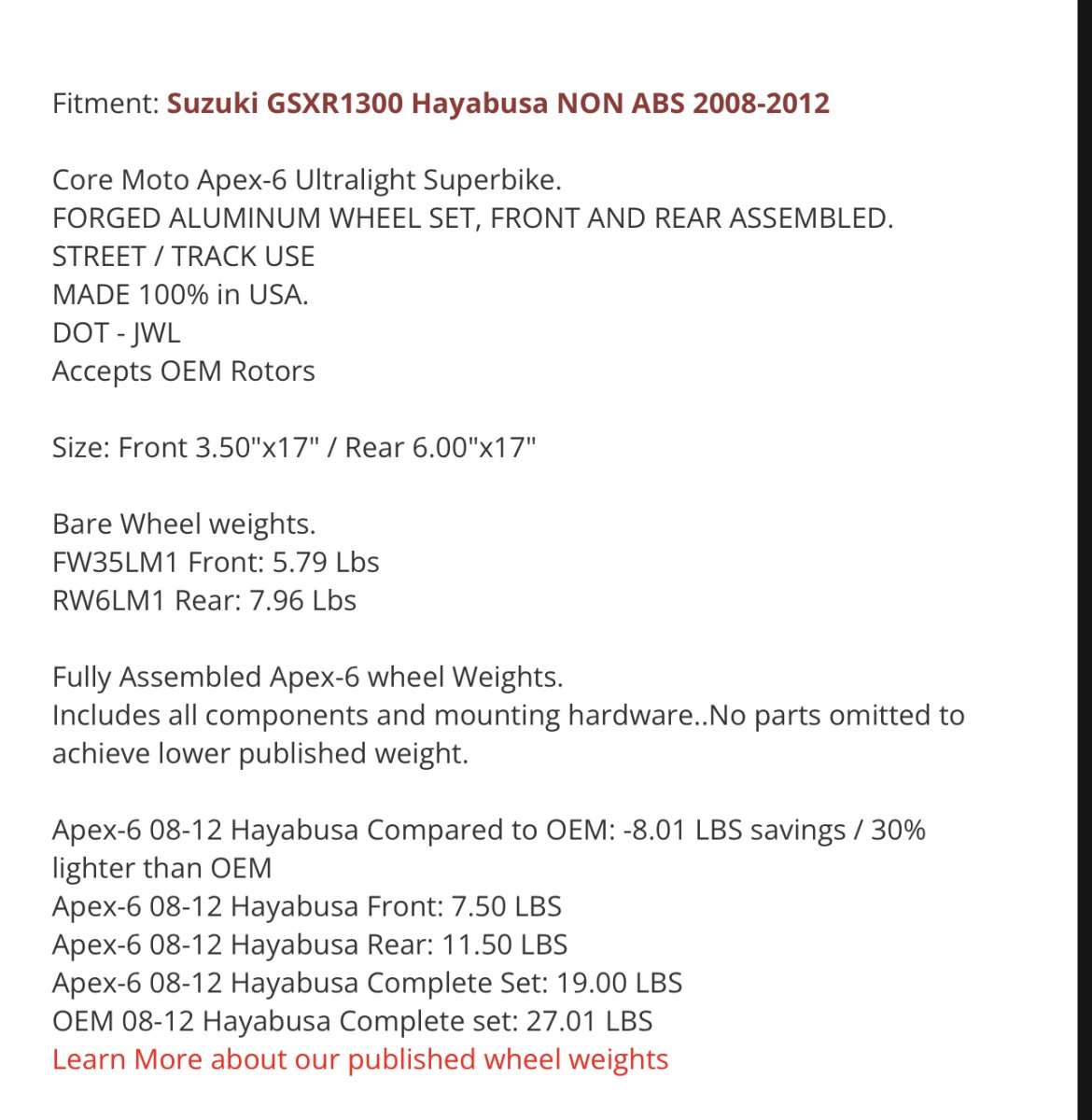

I just put my spare set of wheels on the scales.
No discs on the front and no discs or sprocket carrier on the rear. But both with new tyres.
Front Wheel 20.2 LBS
Rear Wheel 27.6 LBS
So has anyone got the weight of other wheels they have put on there Busa. Just wheel, tyre weight.
There are figures posted in a couple of threads. Yes, one may have to read carefully for the generation of the bike and what is installed on the wheel. But this thread seems to have some level comparisons for example.

2,162
I swapped a core Moto front wheel saved me 4 pounds on my gen 2. Wheels and body work will cost the most to save weight. From what I have learned cutting 1 pound can cost you $50 to $150 bucks. Yes there’s stuff you can do to take weight off the bike for free.
