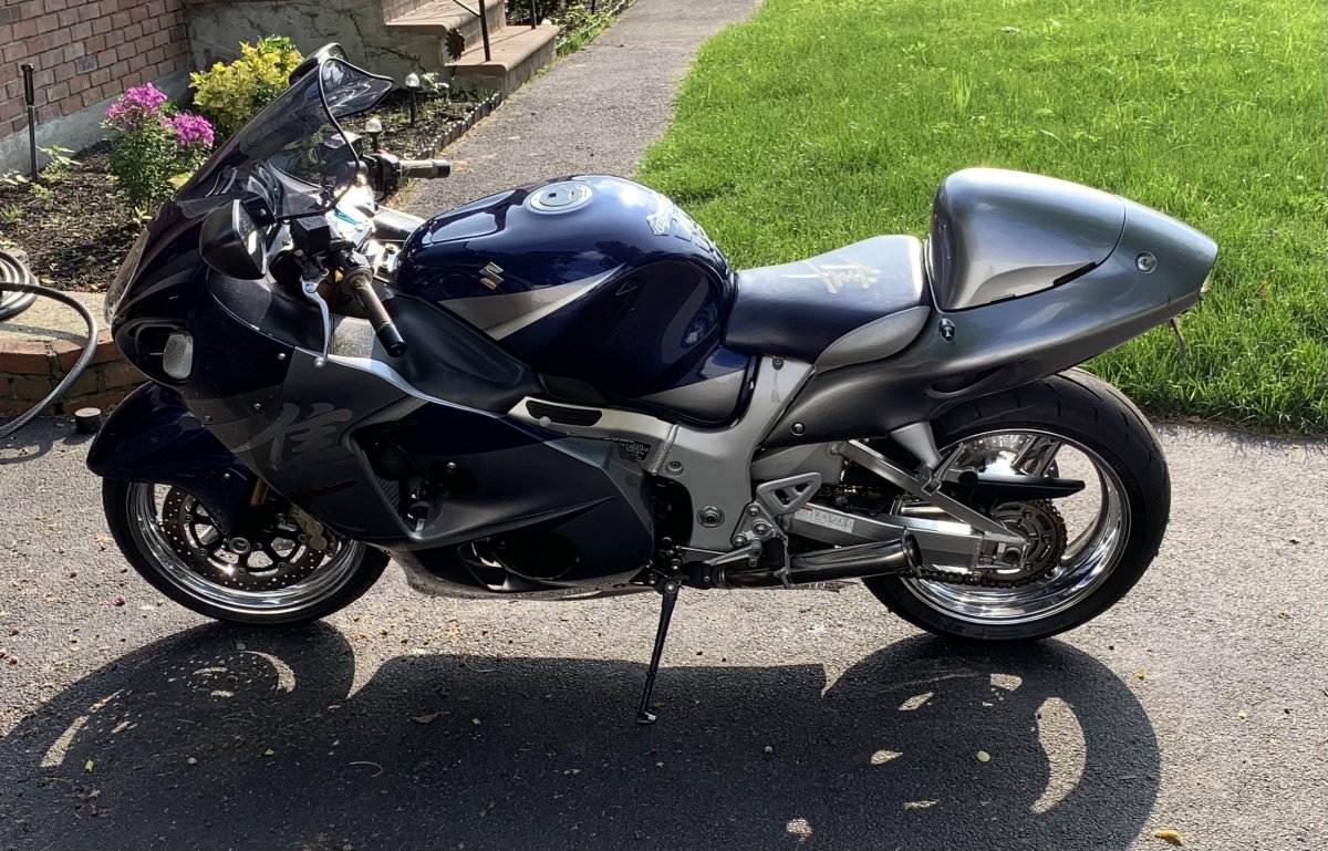

Just picked up a 2006 blue and silver hayabusa which is basically stock accept for an old school dual micron exhaust on it. Bike has 9500 miles on it so it’s done some sitting in a garage. Bike is super clean and I can see the oil is fresh along with the filter. The coolant, brake fluid, clutch fluid, line etc seem to be all original. I’m sure the plugs are original as well. The air filter is also original. Aside from changing the plugs, coolant, brake & clutch lines along with the fluid, and air filter, what else should I be doing to bring this thing to perfection? Had to adjust the idle as it was at 900 rpm. So far loving this thing and boy what a difference compared to my 2013 600rr . Not only is this thing wicked fast it’s so comfortable compared! Should of gotten one sooner! Thanks for any help! Hopefully the pics work!

Looks nice. I see a custom seat and tail tidy too. Did you get the hump and grab bar too? Either way make sure all four bolts, two on each side inside the rear cowl under the hump, are there. You need all four with or w/o the hump or grab bar in place. If it were mine I’d change every fluid, all filters, the plugs (get a new cam cover gasket first) and like you, have the brake lines replaced. My 06 has 70,000+ miles on it and I’ve had Galfer lines on it almost since new. I’ve also used Amsoil and K&N oil filters with 5,000 mile change intervals also since new. Just don’t use the nut to tighten it, just loosen it. OEM air filter though. To vastly improve the stopping power and to go along with new brake lines I’d also add EBC HH pads all around. Oh, check the manufacture date on the tires and replace them if they’re too old. Michelin PR model tires are popular.

got the hump, grab bar, and passenger seat. I took the grab bar off and still have the bolts for it. Tires are Dunlop Q2 with perfect tread and chicken strips . These babies are vintage with a date code of 2009 . These gotta be replaced for sure! I had the ebc HH pads on my 600rr and they definitely made difference. Ordered a head gasket for it and got the plugs along with a filter. Definitely gotta do shorty levers. This thing grabs nothing like a cable clutch! It’s all the way at the end and it’s feels so far away . I need it closer to the grips!

Forgot to mention it also has a hotbodies undertail on it. Other then that it’s pretty much all stock.
