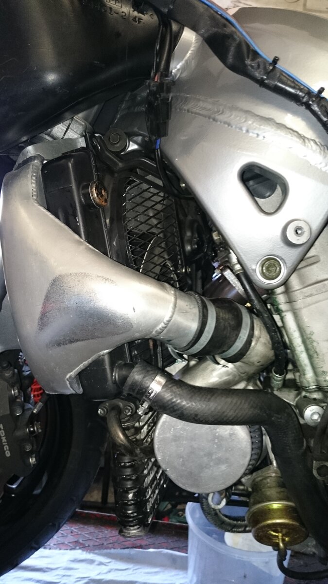

@rubbersidedown
here a pic of my buddy´s german street legal gen1 turbo (with unofficially around 380-420 hp
and the mounted air filter
inside the fairing / no cuts for it at all in the fairing :shocked:
look at its size - it is less than 1/3 of your´s, i guess, and def. no stress with emaciation or "overfatting" of the mixture (due to the filter) for sure - i control its sparks every 1500 - 2000 km and they are in best conditions.
