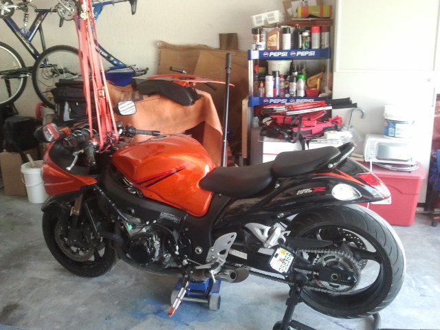

How can I support my front end to lower my forks. Ive already got the triple tree on but would like to lower it a bit more. Besides renting a engine hoist has anyone used their garage truss with some kind of extra support or is this a dumb idea ? Any suggestions would be great. Thanks in advance.

Good news you can support a hayabusa with garage trusses. I reinforced them with 2x4s and used two 4x4s run across themto attatch a chain and to that the straps. Worked out good and got it lowered down.
