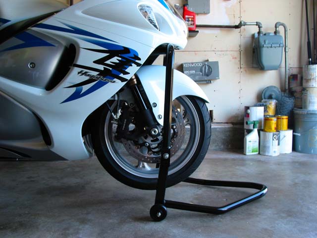

I got to taking apart my front end to fit my new wheel on and found that both fork seals are leaking.So in doing these how do I lift the front and hold it there without the forks on??I am going to replace the seals myself since I am tearing the calipers apart to have them powder coated, put on new lines and rebuild the master.Any tricks I should know when taking these apart??I know there is an 8mm allenhead but where is it located so I can drain the tubes??

front end lift
You need a front forklift stand, and the rear needs to be on a stand too. The bike is unstable on a front stand alone.
The forklift stand lifts under the bottom triple clamp/tree. A pin on the arm of the stand fits into a hole in the bottom of the lower triple clamp.

Or you can buy a Buersig like Sixpack has...:bowdown:
There is another way..Put a 5/8" through the frame and put it on jack stands. From there you can use a floor jack and wood under the oil pan to raise the front.
I am looking at my front stand and I think I can fab up an attatchment for it that will work like that triple clamp lift.I did think abou the oil pan but then I have to take off my exhaust again.Guess if all else fails I can do that but the engine hoist should work.

The lower clamp should be strong enough as it holds the weight of the bike on the ground right??I dont want to damage anything but I think I will fab up an attachment for my front stand that will lift under the lower clamp
